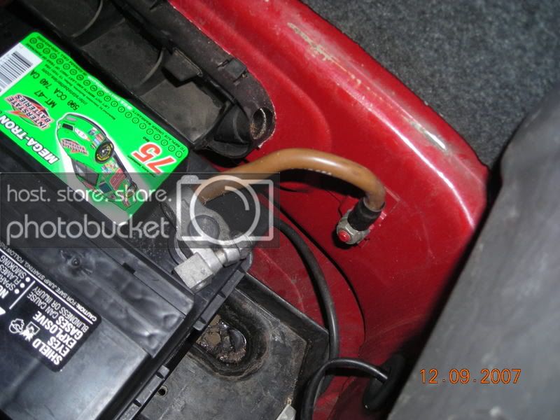

i didnt do the whole big 3, altho it would be advisable...just grounded the bat to the chasis, the power wire from the alt----> battery is already calculated to the power running thru it...what id suggest is making sure that the contacts are good and clean...

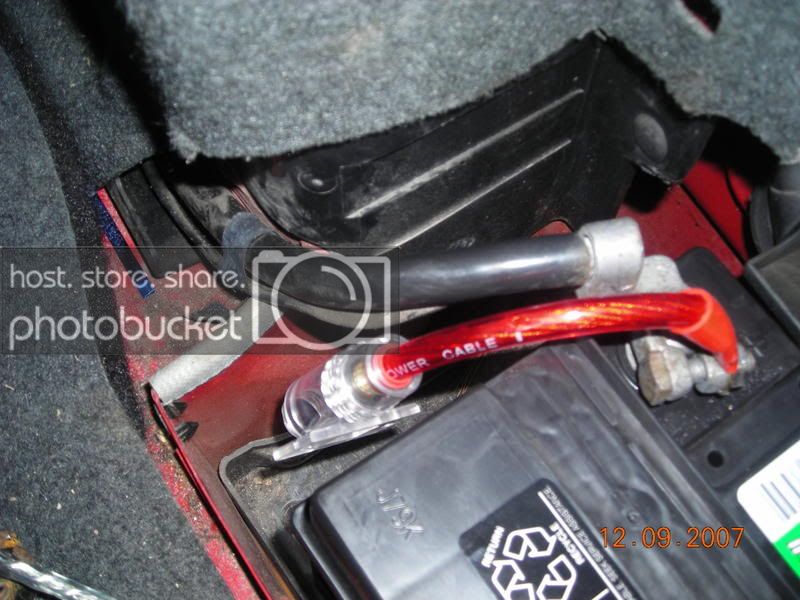

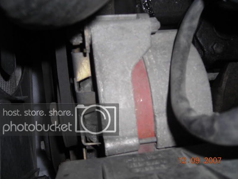

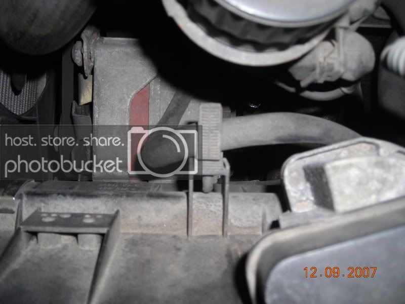

Heres a couple of pics... not sure what they will do for me, but ehh.. Why not. The wire next to the main power wire is 4g, so it is deffinitley bigger than 4g...
The alternator is pretty deep inside...
