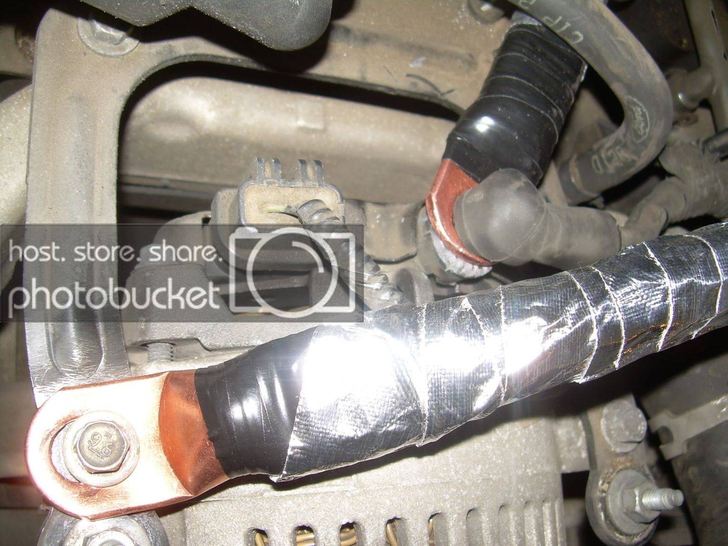

03 Explorer 4.6L, don't know if this will help (only did the big 2 so far, not grounded to frame)
