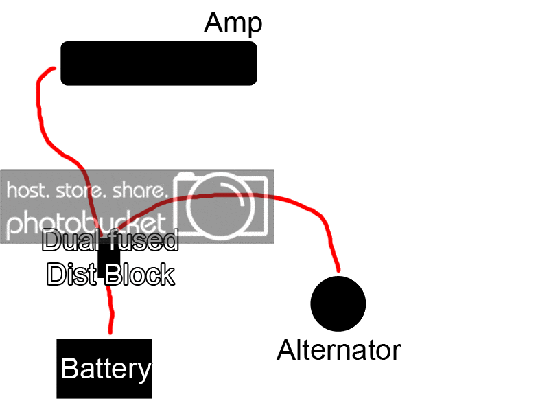

Would this wiring set up work for the Big 3?
Envy my leet design skillz //content.invisioncic.com/y282845/emoticons/smile.gif.1ebc41e1811405b213edfc4622c41e27.gif
you should go to the battery first so the alt can send power to the battery first. if not, it could take power from the alt that would otherwise maintaine the rest of the car. sometimes,also, the alt will have dips and spikes that the battery will help to smooth out.
I ended up going strait to the battery anyways, the idea for that came up when I couldn't find any of my fuse blocks.
becareful bud with no fuse though
It is fused. Guess I should have put that little piece of info in //content.invisioncic.com/y282845/emoticons/tongue.gif.6130eb82179565f6db8d26d6001dcd24.gif ALT to Battery is fused @ 60a as of now. If it does pop it (doubt it will only being 100a alt) I can always jump it to 100a.
