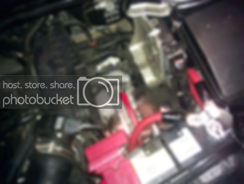

here's my electrical setup. 0ga running to the engine block under the air filter, one run to the chassis to the right of the batt, and one run from + to the alternator.
I use that same terminal clamp, i never thought to use the screws instead the designated place to place wire..
