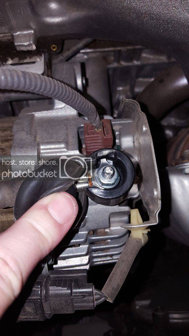

MANTI5 10+ year member CarAudio.com Elite 1,488 19 Southern AZ Jun 11, 2016 #1 Has any ever seen an alternator like this? Any ideas on the best way to remove that thing so a 1/0 sized ring terminal can fit? Click to read more...
rfluvinmf 10+ year member CarAudio.com Elite 547 4 LOUISIANA Jun 11, 2016 #2 Looks like your 1/0 will slide right undneath the existing wire. Have you test fitted a 1/0 lug in this space already?
OP MANTI5 10+ year member CarAudio.com Elite 1,488 19 Southern AZ Jun 11, 2016 Thread Starter #3 What do you mean underneath? That black plastic ring/cap thing is way too small for a 1/0 terminal.
The Camry Hey, I Try. 3,001 3 Western Oregon Jun 11, 2016 #4 What do you mean underneath? That black plastic ring/cap thing is way too small for a 1/0 terminal. Click to expand... If its plastic. Just take it off/trim it. Sent from my SGH-T999 using Tapatalk
U ummduh 10+ year member Member 65 4 SE Wisconsin Jun 11, 2016 #5 You could replace the short nut with a threaded coupling, and simply bolt it to the top of the coupling, if you don't have any interference issues. A coupling just looks like a nut, but it's 1-2" long, it's meant to join sections of threaded rod together. Many decent hardware stores have them.
