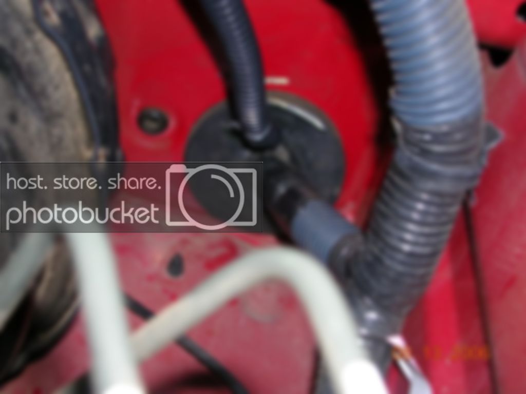

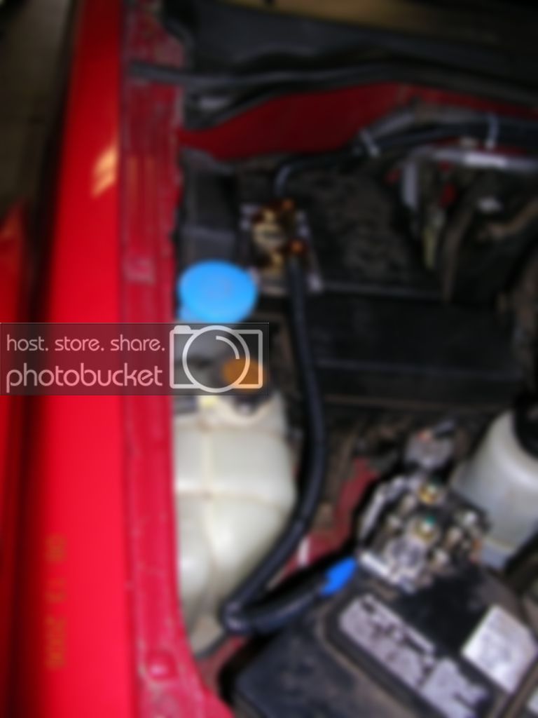

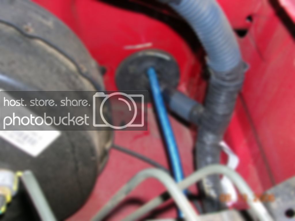

Here are some extra shots of my setup. I too have an 05 Nissan Frontier.
power wire & fuse:
Power wire @ cab grommet, pre-loom
Power wire @ cab grommet w/ loom
Ran RCA's, power wire, & remote wire down passenger side, with NO issues.
