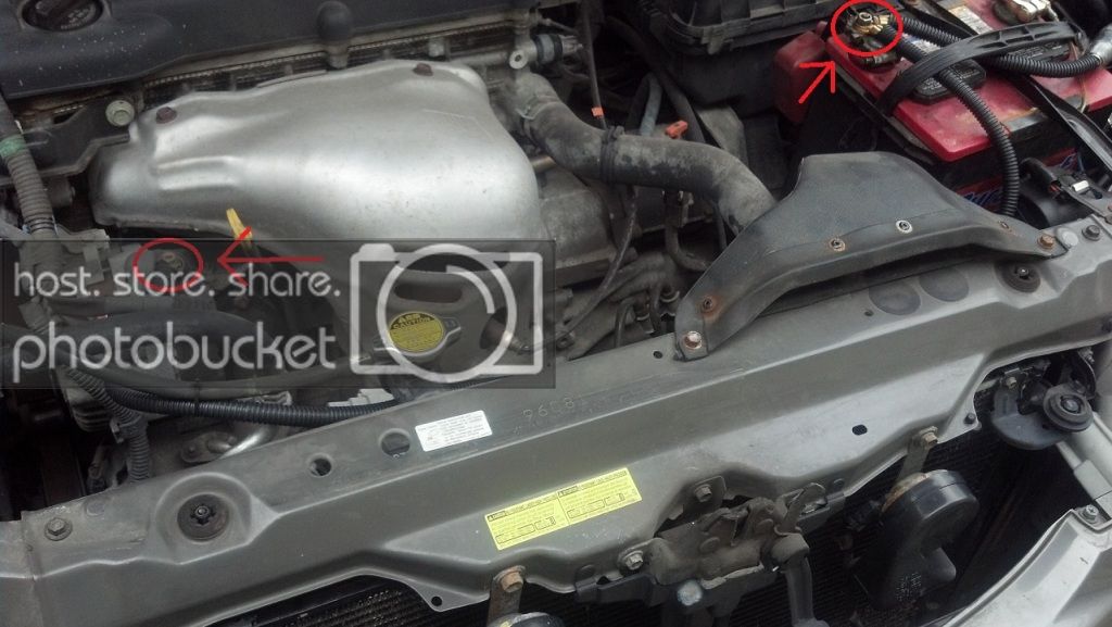

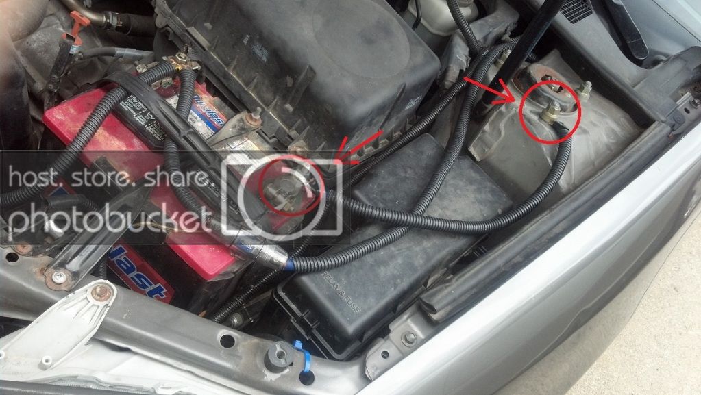

did the big 3 on my car wondering if i did it right, i uploaded pics below

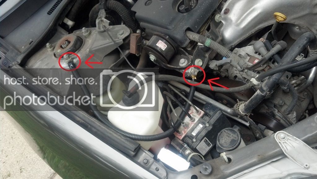

Engine block to chassis

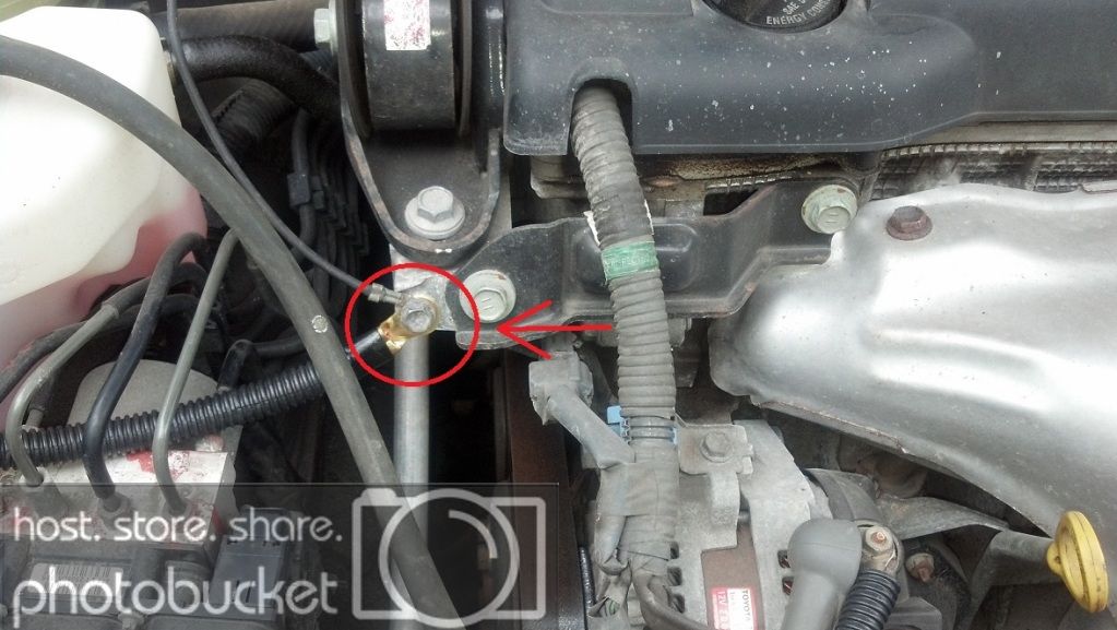

Where i placed on engine block
battery ground
alternator to battery positive
Mmm, we will see what others say, my opinion is the ground to engine block should be on the engine itself or the OEM engine ground, I know it is hard to get there sometimes but if not a bolt on the engine itself that is holds a bracket or something. I would not use that engine block ground.
Looking at the picture on a bigger screen later, it does look like that engine block part you picked is near a motor mount and part of the engine itself, also I noticed another existing gnd that may appear to be from the original manufacturer. This means it is good.
Yeah, i can take more pics of that area from a diff angle if u want i bolted it to an existing nut right on the block

Because i dont have one, they are grounded on the strut tower supports that lead to the frame (i think). And pic close to the engine so basically im asking are these common places for grounding? And do they work? Does anyone else have them in these similar areas like strut towers and front of the engine? Or should i pick difference places? Thank you very much
