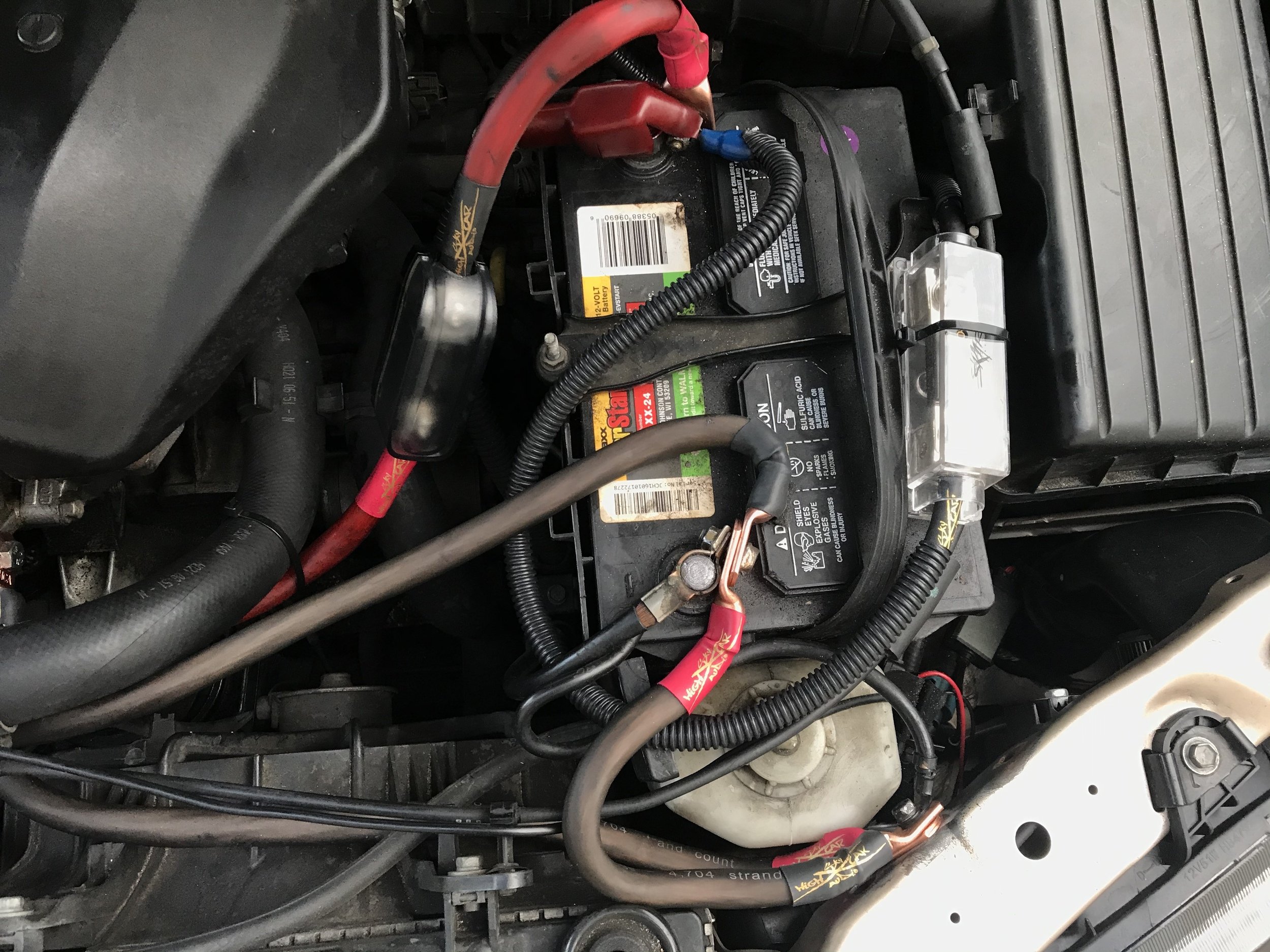

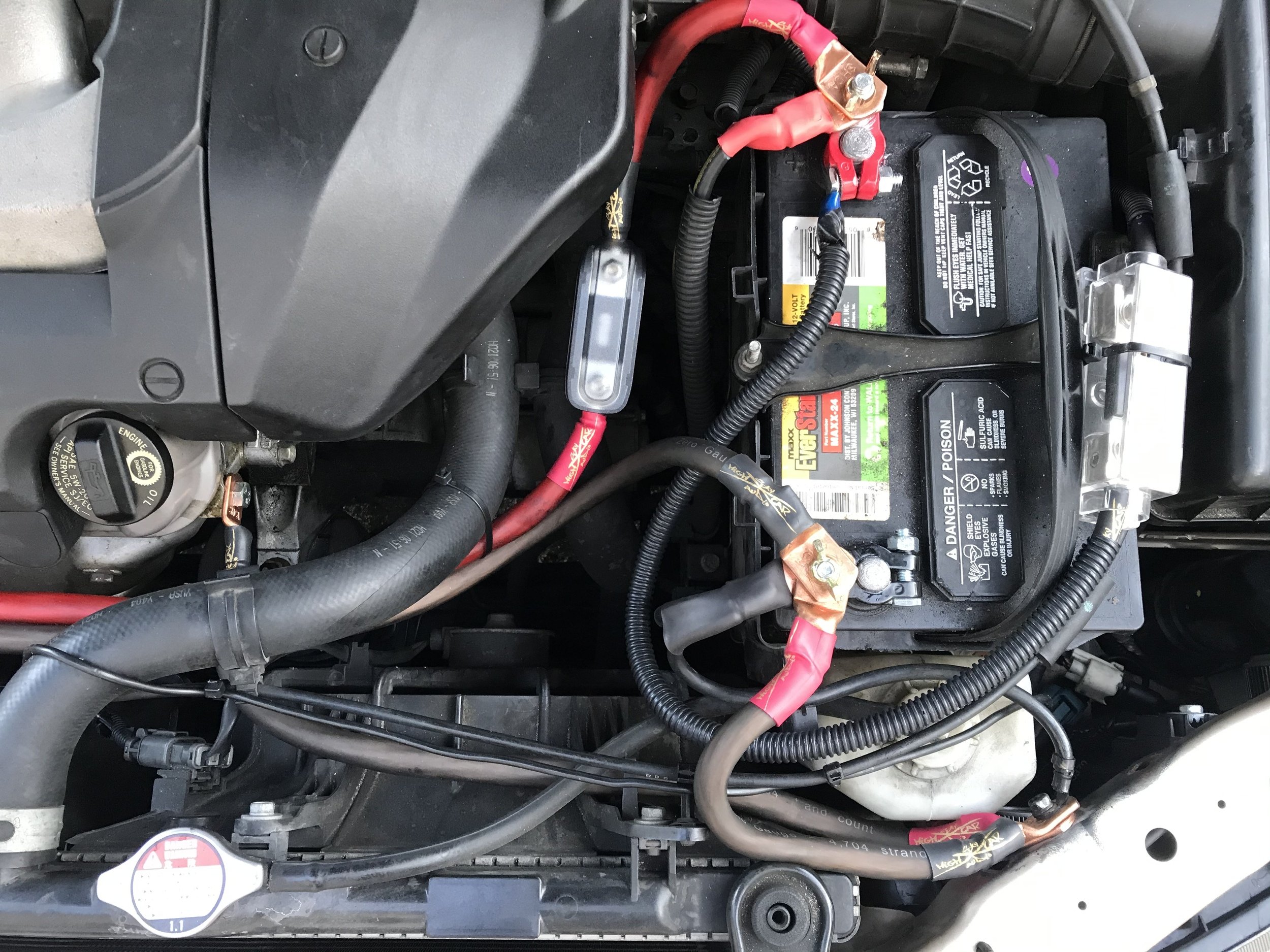

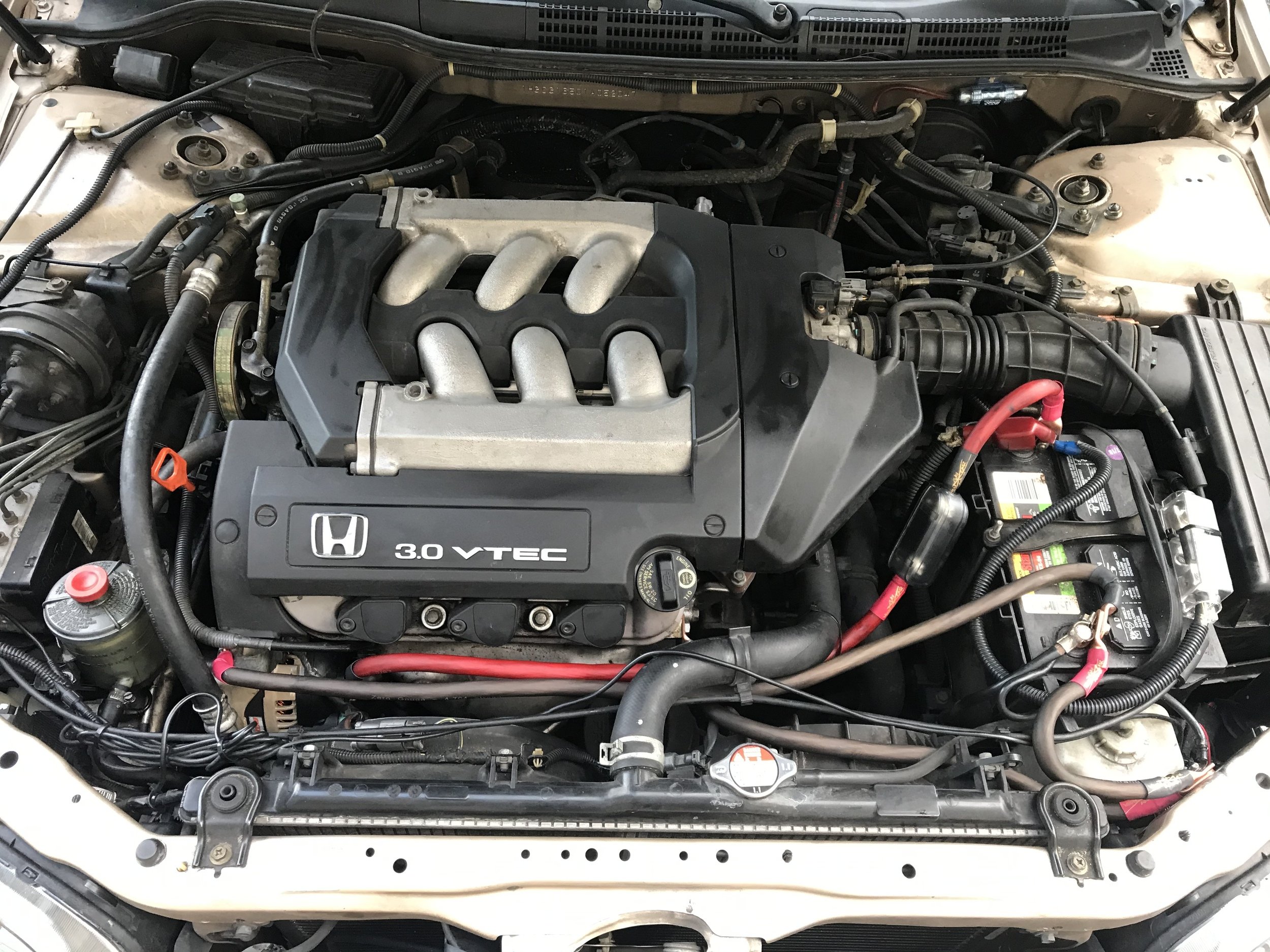

Just got done cleaning up my big 3 connections.
Thought by doing this I would increase my voltage a little bit but that’s not the case. I idle around 14.3 right now. I’m running a 1500 amp (subs) and a 1000 amp (mids and highs). When i’m at full volume and knob turned half way and the lowest i’ve seen is an 11.9. I’m scared to go more on the knob for fear i’ll drop into protect mode territory. My ride is a 2001 V6 Honda Accord (known for the ELD bs). My electrical setup is a Mechman HO 240 alt and Mechman 1/0 OFC cable. I’ve also grounded my alternator to my battery negative which i’ve heard mixed things about doing that. Anyways, any conversation would be much appreciated and i’ve attached pics too. Thanks peeps!

Hey guys!
(Stock battery too)

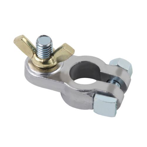

Get rid of those terminals and get a set of exactly these terminals. ZINC Terminal or "Marine" Terminals.

Awesome! Thanks for the help man!
Just wanted to give you an update as to how it went. These terminals saved my *** man! Lowest voltage im seeing now is like 12.4 and that’s a 3/4 bass knob turned up. Thanks man! @ThxOne

After looking at the pics again, Try measuring at your battery with a DMM. Looking at your pictures it looks like you may only be running 4 gauge? I suspect this is the remaining problem.
