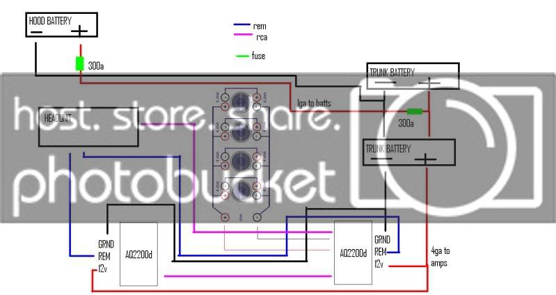

ok, ill have a run of 1/0 going to a battery in the back. i will have 2 aq2200d's, and a kicker amp for my speakers.
whats the best way to wire this? i have a http://www.knukonceptz.com/productDetail.cfm?prodID=KNF-12 from a previous install btw
i dont know if the aq2200d takes 1/0 or 4/0
would the best way be to wire this like 1/0 from back battery to a distroblock which goes to the kicker amp, and then another run of 1/0 from the battery to the amps? or what?
I would just run 1 ga to the back batt. Then connect all the amps with 4ga to the back batt + and -. With proper fusing of course.
kk. so a run of 4ga to each of the amps. ill do 1/0 distro to 2 4ga tho for the sub amps probabbly to keep it clean looking, and since i already have the distroblock. thanks for the quick repsonse!
is this right?
why 125amp? those amps must draw a lot more than that Loop
4 awg is rated to 125A //content.invisioncic.com/y282845/emoticons/fyi.gif.9f1f679348da7204ce960cfc74bca8e0.gif
If the amp has larger than 4 awg inputs, then use the proper size wire with the proper sized fuse.
kk. so this is where im at.
single run of 1/0 guage to back batts, if a fuse pops, i know ill need another run.
1/0ga to the amps.
fuse on both ends of battery to battery wire, and fuse right after the battery to the amp
