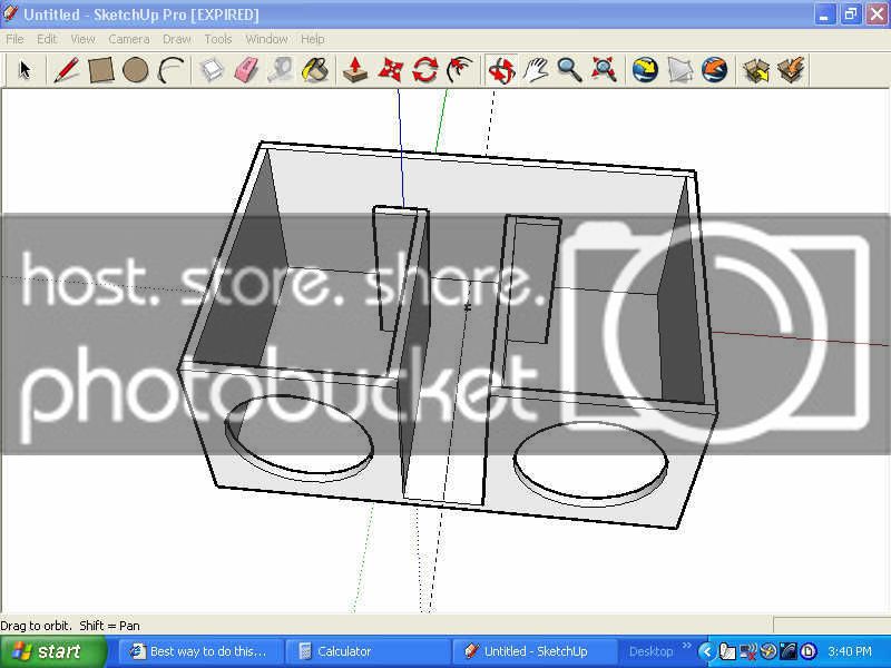

NissanKicker 10+ year member Honda-on-22-Nissan-on-20 1,435 7 Ruston/Grambling, LA Jun 27, 2008 #62 4.14cuft after sub & port displacement - tuned @ 32hz ... 35"W x 15"H x 24"D
OP jco1385 5,000+ posts expert jcologist 19,957 84 Mobile, AL Jun 27, 2008 Thread Starter #63 thats more like it. dimensions? is that .14 ft gonna fck me in the ***?
NissanKicker 10+ year member Honda-on-22-Nissan-on-20 1,435 7 Ruston/Grambling, LA Jun 27, 2008 #64 They are underneath the picture... ... lol... NOPE! ... Can you put a 24" D enclosure in there
OP jco1385 5,000+ posts expert jcologist 19,957 84 Mobile, AL Jun 27, 2008 Thread Starter #65 i think so. can you make it 16" tall and shallower? will that work? i know 16" tall is my max
NissanKicker 10+ year member Honda-on-22-Nissan-on-20 1,435 7 Ruston/Grambling, LA Jun 27, 2008 #66 That's why I made it 15"... ... Giving some room for the air to get from the trunk to cabin.
OP jco1385 5,000+ posts expert jcologist 19,957 84 Mobile, AL Jun 27, 2008 Thread Starter #67 meh, fck that. the one i have is 16" and it's fine. there's about 1.5" on each side thats open
NissanKicker 10+ year member Honda-on-22-Nissan-on-20 1,435 7 Ruston/Grambling, LA Jun 27, 2008 #68 Now you have an 1" at the top.
OP jco1385 5,000+ posts expert jcologist 19,957 84 Mobile, AL Jun 27, 2008 Thread Starter #69 i'm gonna walk out and see where 24" lands. i'll brb
OP jco1385 5,000+ posts expert jcologist 19,957 84 Mobile, AL Jun 27, 2008 Thread Starter #70 ok, i think 24" will be ok. problem i see is idk if i'll be able to slide the box in. my trunk opening isnt very deep

OP jco1385 5,000+ posts expert jcologist 19,957 84 Mobile, AL Jun 27, 2008 Thread Starter #72 lets try this... 16" tall. 35" wide. 26" deep bottom. 22" deep top. (with the slant) thats exactly the dimensions i want it to be. i just measured it out.
OP jco1385 5,000+ posts expert jcologist 19,957 84 Mobile, AL Jun 27, 2008 Thread Starter #73 sorry to keep switching it up. that is my final answer. smaller is always better. is 4 cubes too mutch/enough? can i get by with less?
