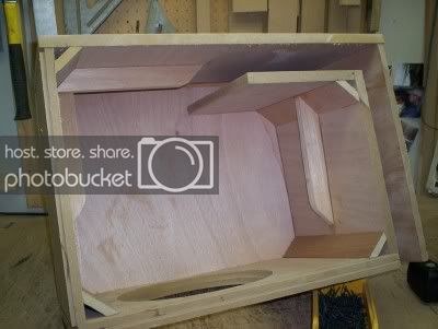

best way to brace
make shure the bracing runs in line with the airflow
in the enclosure..you do not want any turbulance inside
the enclosure....
the secret to good bass is good airflow..the smoother
the air can move,the smoother the bass
bracing that resembles any sort of a wall or screen door
will cost output and change the woofers cupping of the air
and will result in depleated performance
make shure the bracing runs in line with the airflowin the enclosure..you do not want any turbulance inside
the enclosure....
thank you for the pic //content.invisioncic.com/y282845/emoticons/biggrin.gif.d71a5d36fcbab170f2364c9f2e3946cb.gif
hazardous0388 is totally right. Keep your bracing via the air flow, tie in the walls, and 45 the corners. The better the flow, the better the bass.
Hope this has helped you.
cutting a side wall in half (ex. threaded rod in the middle) is better than double layering. that is simple high school physics.
double layering produces a deader sound increasing SQ...
even with a threaded rod the MDF still vibarates
I used to use threaded rods about 2,000 boxes ago
but propper bracing with MDF stiffins the walls better
than a rod
place a quarter on the top of an enclosure and pound the subs...
if the quarter bounces or vibarates around on the box there is
room for improvement
if any pannel is vibarating energy is being wasted
exciting any air anywhere other than the port and woofer
cone will have an effect on out put and sound quality
there is always the option of doubling up on the pannels....
this enclosure does not need bracing
an enclosure with doubled pannels has a much better sound
than an enclosure with out
