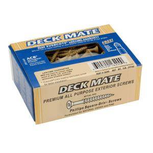

i like to use these...they counter sink real well in mdf and hold my speakers in really good:
