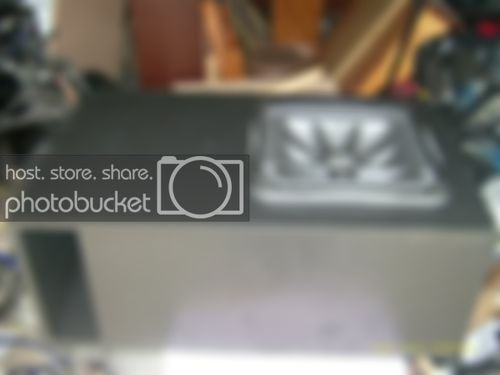

duplicolor here too was like 12 bux at lowes, ised a 3/4in matt ? basically how thick the roller is.. rooled it on 3 coats and to get corners and such used a regular brush you could use a regular roller but wouldnt get any texture at all and this isnt like line-x at all really not that you would want that or expect it but to get that super rough texture you have to use a spray gun and thats a messy job
just let the thing air out a few days before stuffing it in your car it wont be pleasant for about a week
also i like that its not as rough as real bedliner, and if you want less texture you can use a different roller its pretty slick though if you dont already have your box secured you definately should
Some of rustoleum brand it is much more slick
Some of duplicolor, be kind these we're some of my first boxes years back
Also if you are just wanting the texture look. Try adding some texture into paint. A recent box I built
