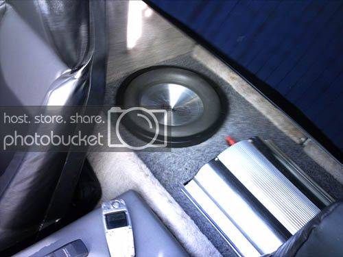

this is what I did with my 86

More advice, i'd make an enclsoure (like I did) for the storage container. It wasnt particularly hard to make (I fabed it up with cardboard, then put fiberglass over the cardboard, then resined it to a 3/4" peice of MDF). Id suggest something like a 10" Alpine R dual 2 sealed.
