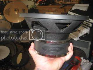

I have a single 4 ohm concept 10 that I will sell for 40 Shipped. I have two others doing GREAT on 150 RMS each, but they can take 250-300
Like new condition.
