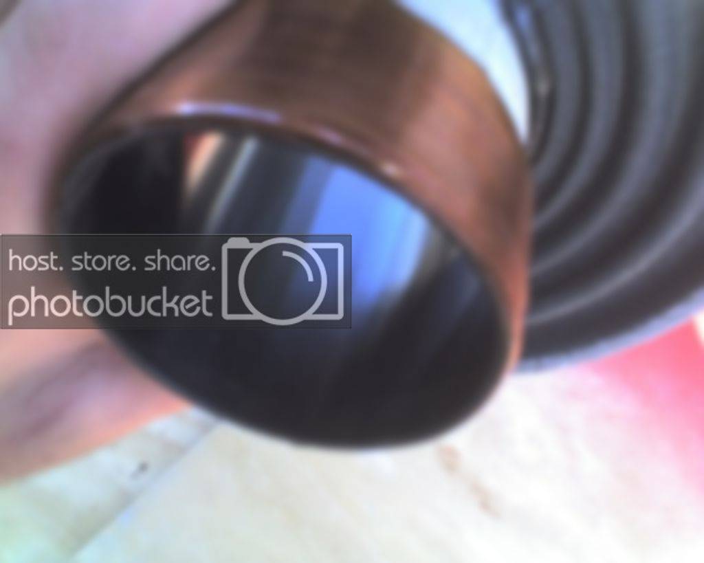

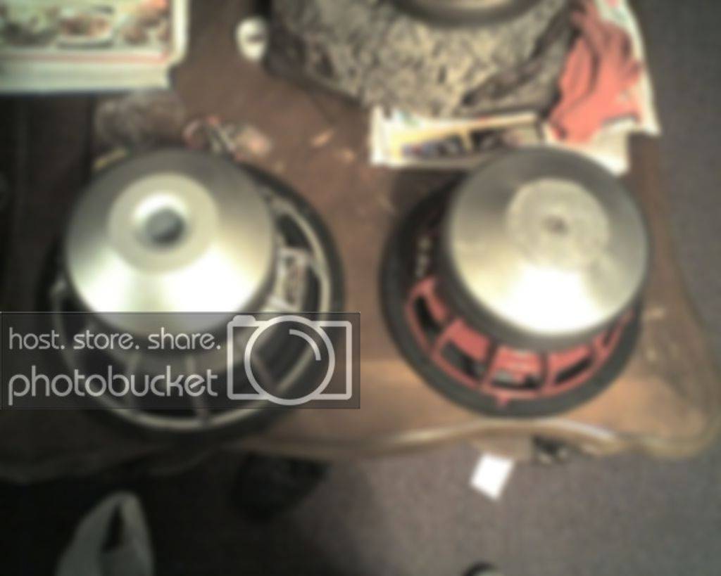

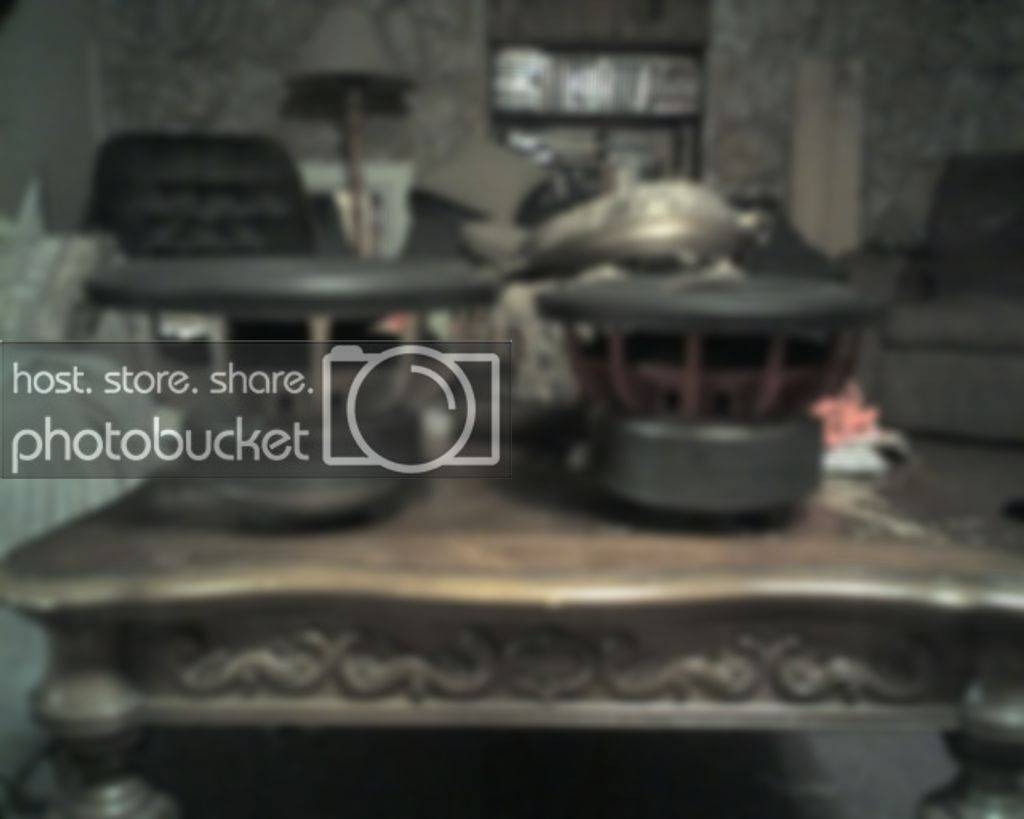

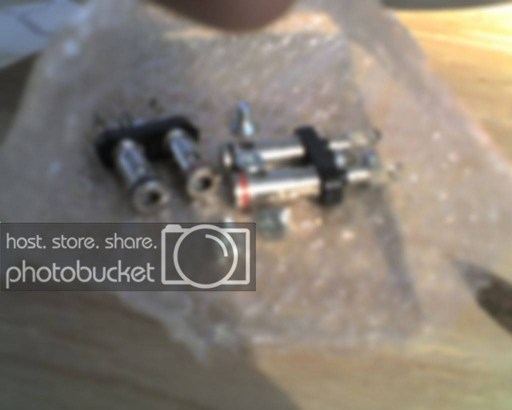

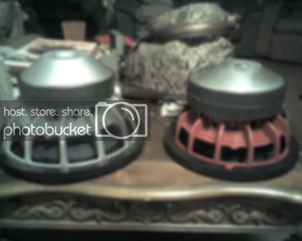

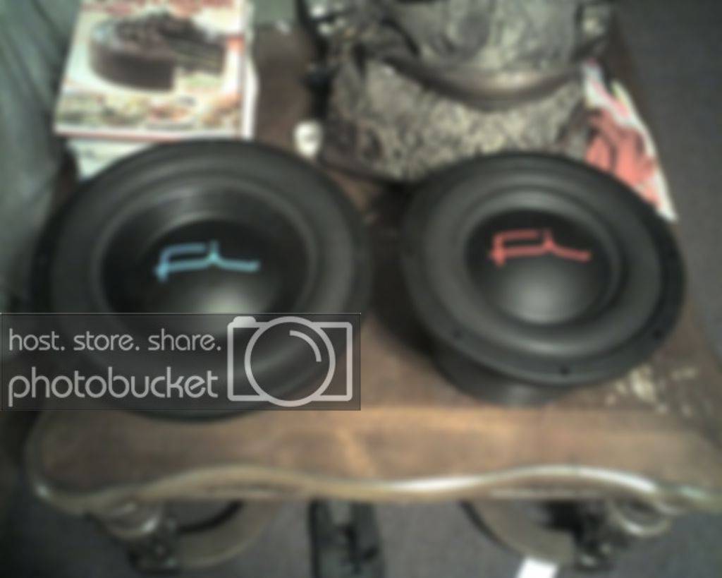

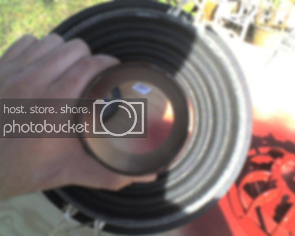

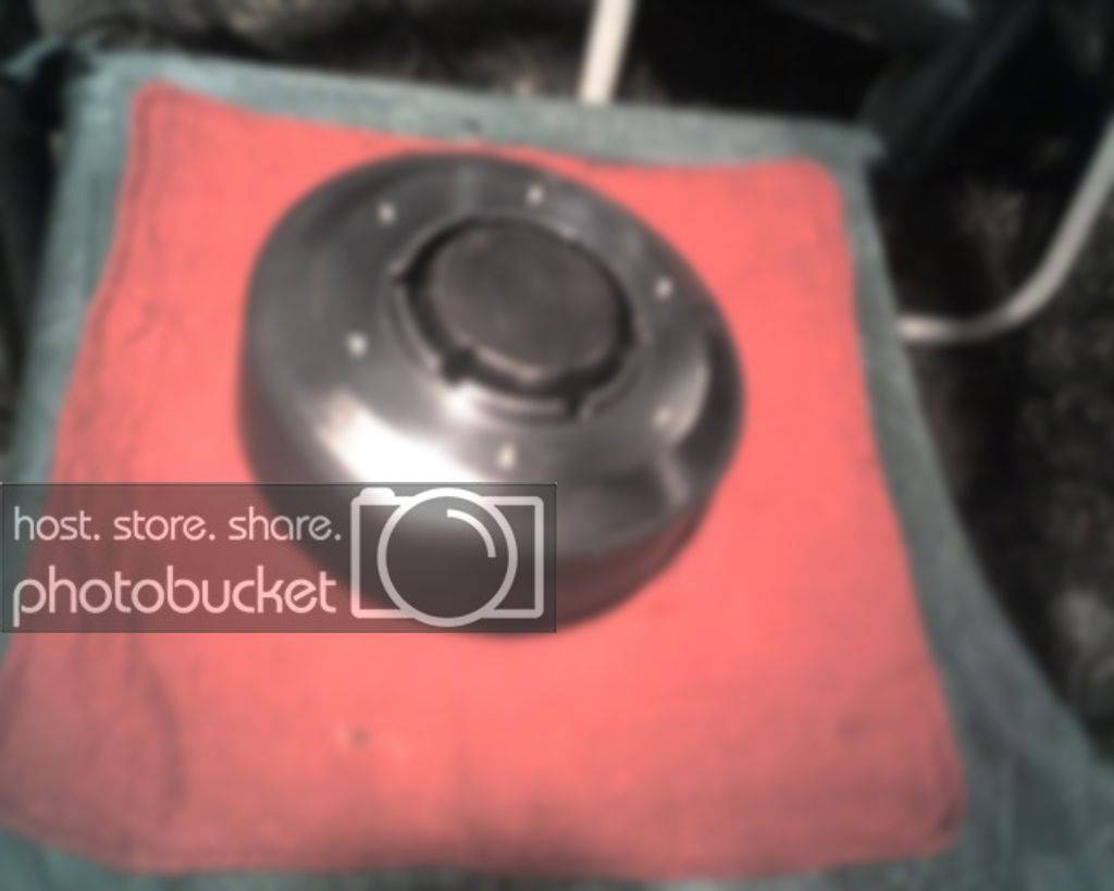

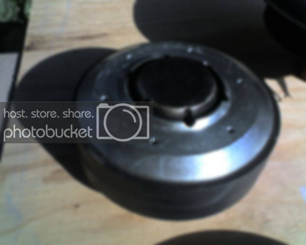

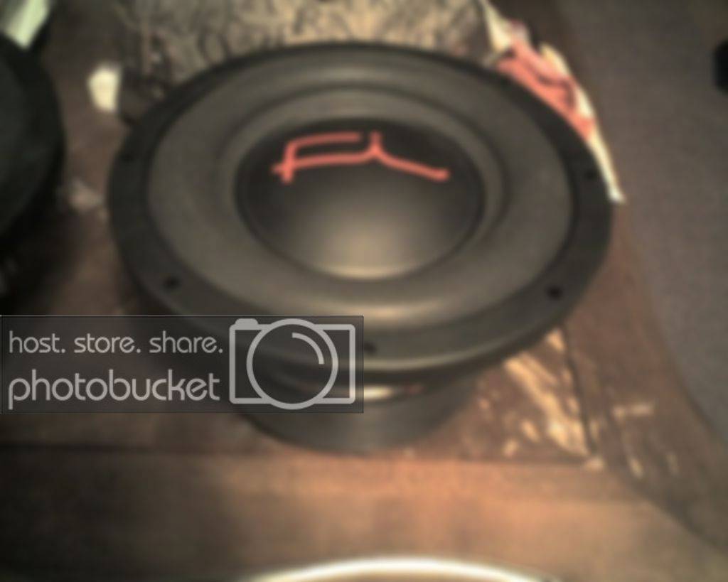

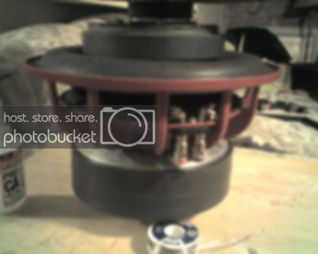

Fully loaded Fi bl motor. Recone consists of 2 stiff 2 medium spiders 8 layer flatwound long throw d2 voice coil and 16 lead wires (4 per terminal). The whole idea was to get the most out of this motor that has been sitting around for months. Sub was built to handle 2krms+ daily.
Lemme know what you guys think.

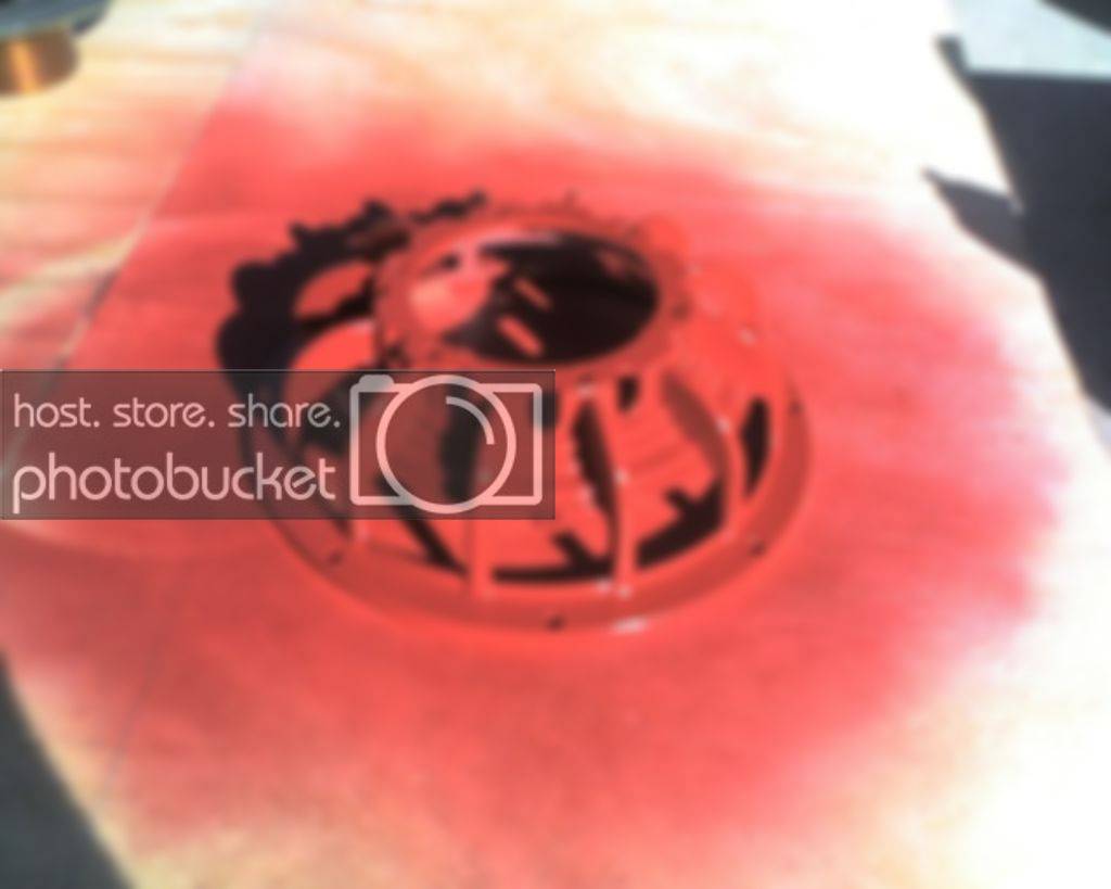

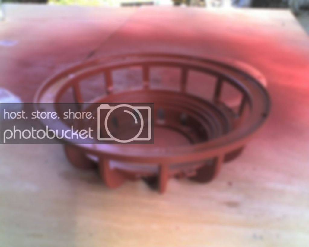

Lmao it is actually going in the q logic enclosure. It was givin to me but was meant for a 12. Has the gay as removable baffle so Im just gonna cut a new one wrap it in red crushed velvet and use it for now. Its 1.5 cubes tuned to 38hz so its perfect for the ten. I sold 4 15" chaoss to down grade to an sql system. lol I did paint the spider and surround landings and started sanding them with a wire brush and it would not come off. Painted it with heatr treated engine block paint so its pretty hefty sh1t. I free aired the sub to full mechanical excursion for about 20 minutes and everything seemed to work beautiful.
