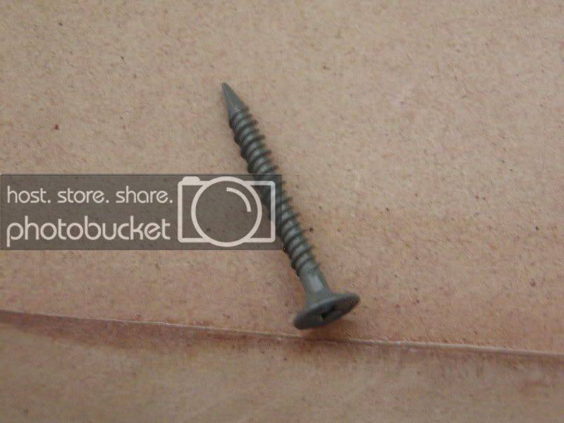

I liked these a lot. They were for wonderboard I think it was called. It was like asphalt inside plastic mesh. Anyhow, these screws are beasts.
