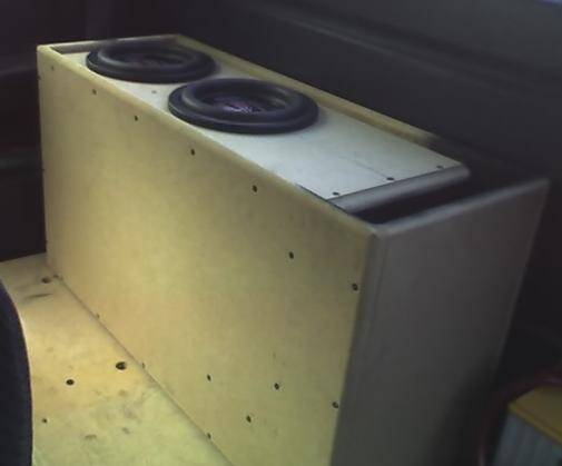

Best screws for 3/4 mdf?

Not that it matters much, but if you already have the screws in, why waste the time of taking them out? I'm just curious really. I understand the whole making it smooth, but can't you just add the filler on top of the screw (if you countersink them, obviously)?
Many reasons, one example is so you can run a router over it smoothly without worrying about hitting a screwhead and destroying a $20-30 or so router bit.
The truth is, you can just use 1 5/8" fine thread drywall screws. You don't have to pre-drill as long as you stay 2.5" away from the end of your boards.
You can put alil pressure on the fine thread screws and counter-sink them when they go in. I never hit em w/ the router....they work great and their FAST. I also use Titebond 2 or 3.
Oh ok. I usually just let it be, because I just carpet my boxes. Never really bothered me much since it would be covered.
