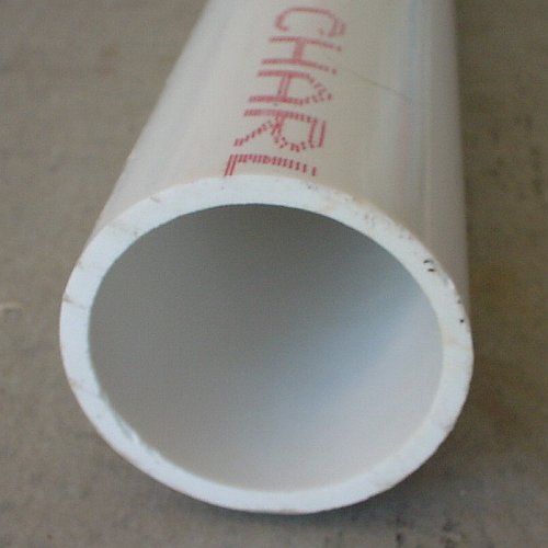

I've noticed this trend on this and many other sites and I see many people perpetuating the information that this is an aero. It is not. It is a round vent, in this case manifested by a PVC pipe. A round vent is simply that; round.
Aero is short for aerodynamic. Aerodynamic indicates a low drag coefficient. A round vent cut flush with the surface of the MDF, or whatever you're building with, is not aerodynamic at all. A flared end is what constitutes the term "aero" and facilitates the aerodynamics for a round vent, or any other cross section for that matter.

One flared end is better than no flare but still half-a$$ed in my opinion. I would assume most people use two flared ends if they had the inclination to use an aero to begin with.
The whole point of the flare is to reduce drag and increase efficiency, ultimately reducing compression and turbulence.

Flared ends mainly benefit those who want to retain the use of a small cross section area. You could easily overcome the effects of compression by simply going overkill with cross section area but there are ramifications with that approach, nothing is a free lunch. It's all about the application. I simply wanted to get it out there that a round vent is not an aero as so many hold it true.
