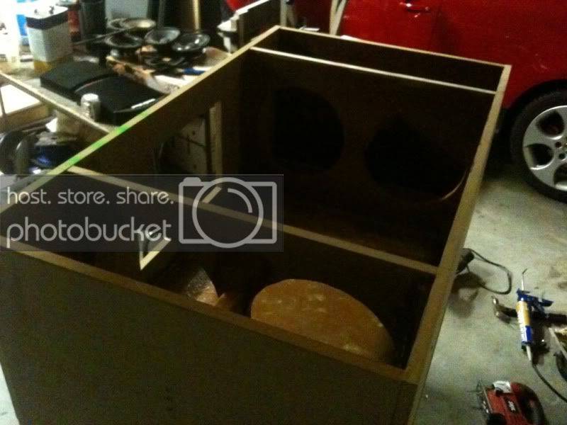

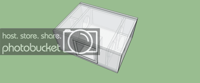

Rough sketch/build of the box.

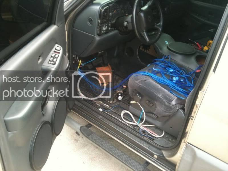

Doors.

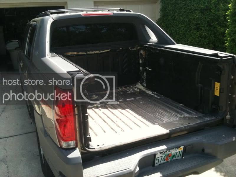

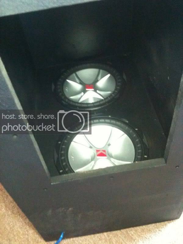

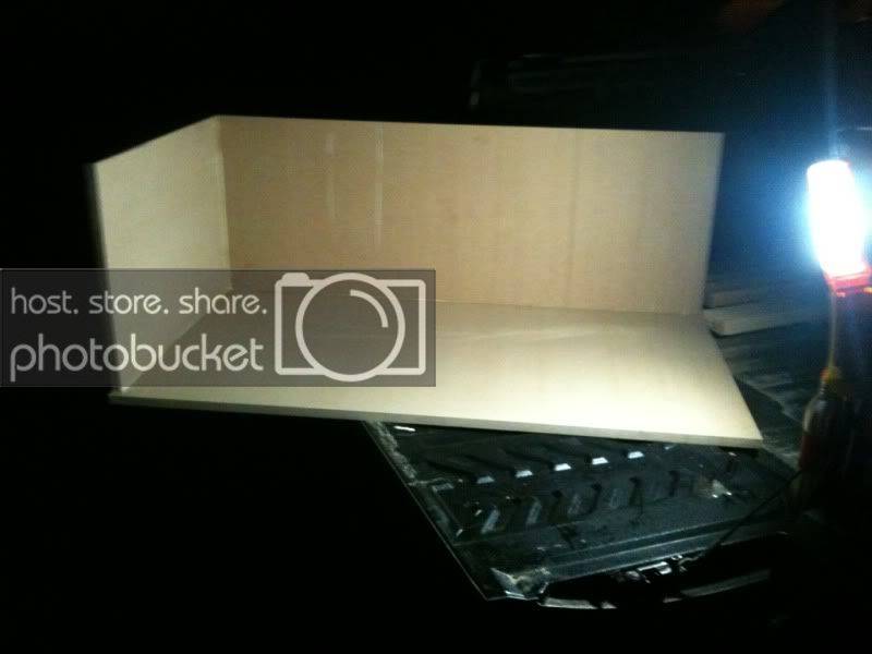

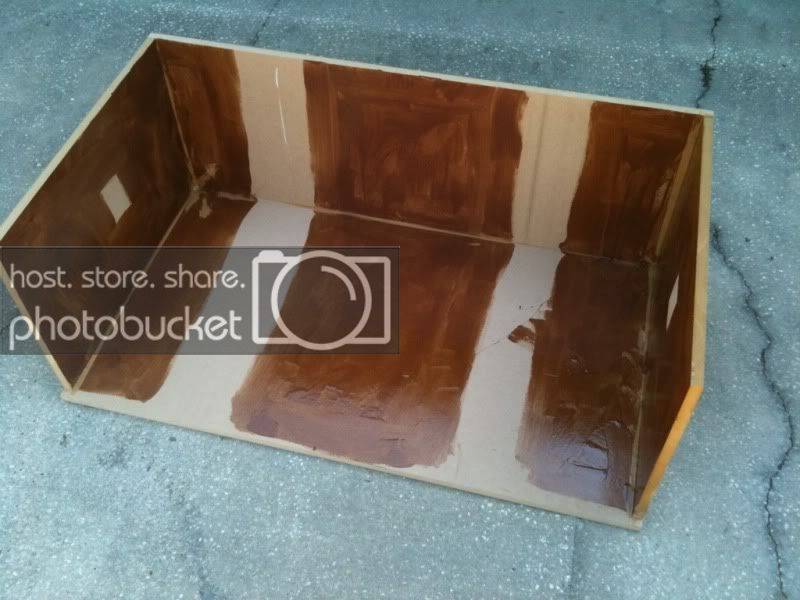

Box without a port.
Battery rack.

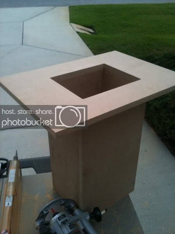

First port. Sounded great. Tuned at 40hz. Really low for a bandpass. Peaked at 29hz legal. Was 122in^.
New port. Its 80in^ tuned at 30hz. Plays retarded low. The truck plays nasty in the teens and low 20s.

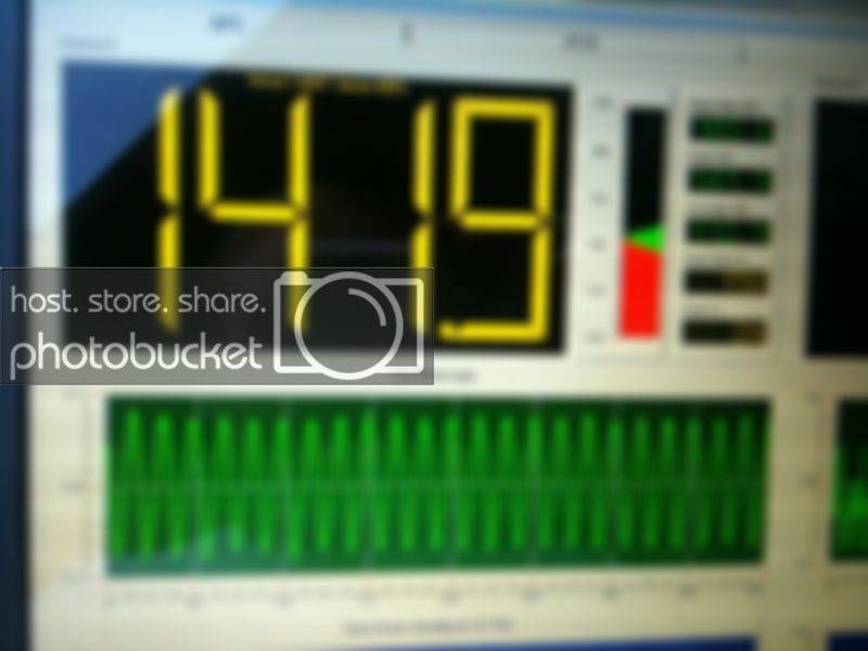

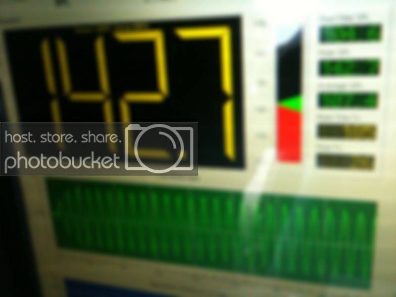

Did some metering with the new, smaller port. I never play the truck sealed up, so I didnt even meter it that way. I designed the truck to have loud *** doors so I can open the truck up and play the crap out of slowed down music. Low bass with vocals you can feel in the ground. Thats exactly what it does. So these numbers are on the dash with the drivers door open. 4 CVR 12s on the Massive N4 2kw amp @ 1ohm.
141.9 @ 24hz.
142.7 @ 26hz.
Was still around a 138.x in the 15hz range.
