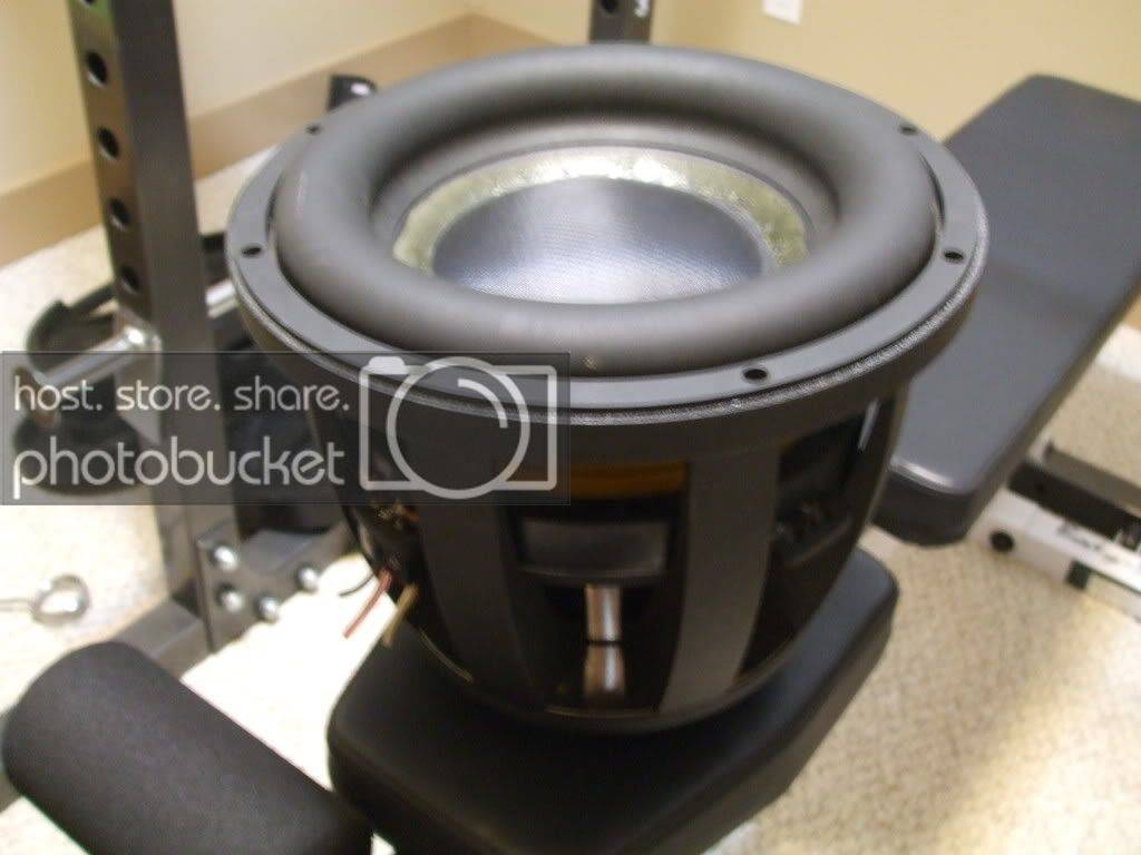

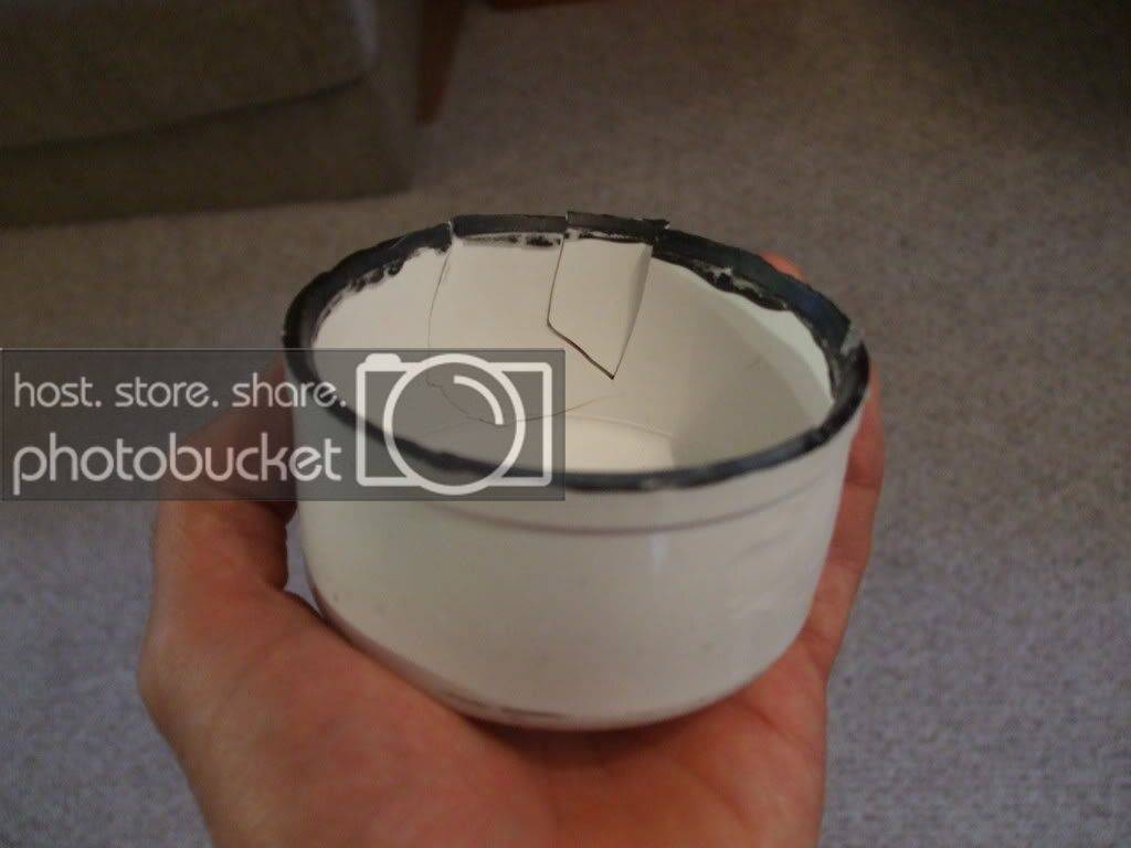

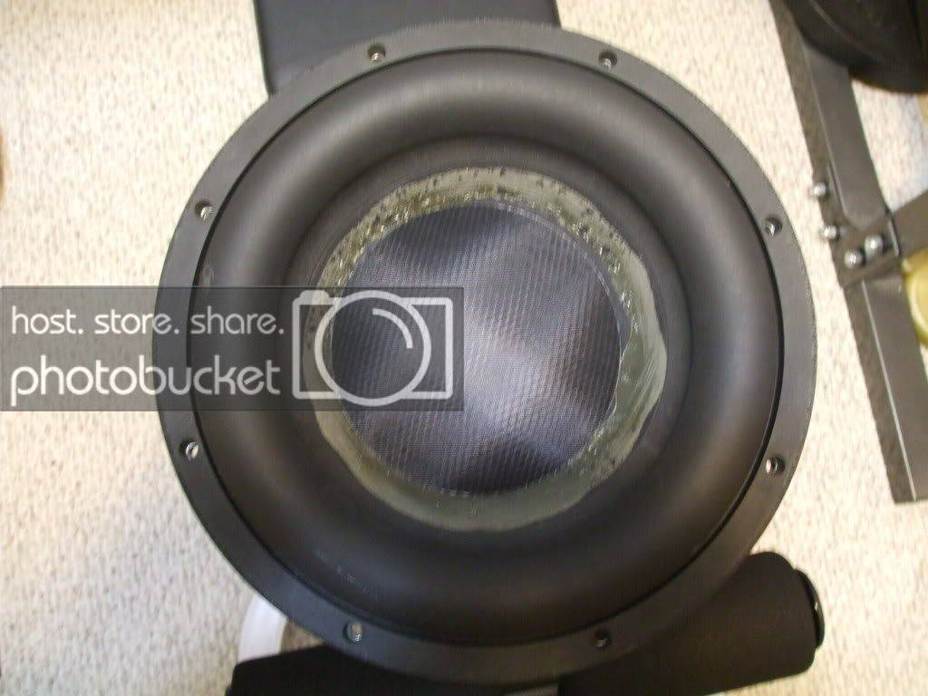

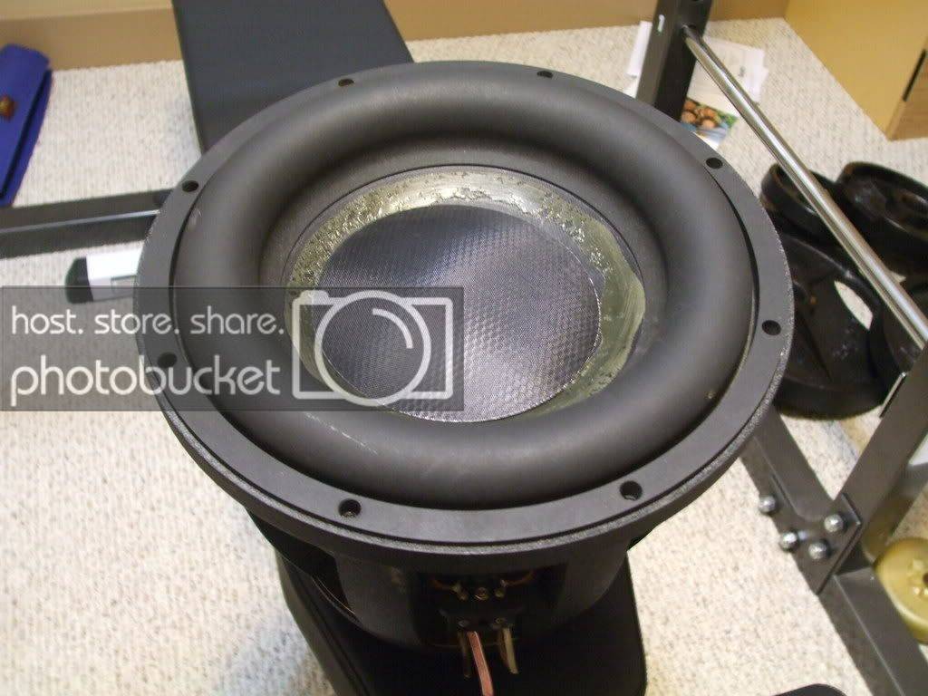

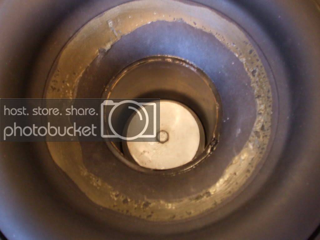

So NeedDirections, remember that MX I bought off you? You said there was a rattling in the cone and the impedance was going nuts on you. So, I decided to do a bit of surgery to the sub. Seeing as it's a dual cone sub, I removed the top cone to see what's rattling inside. It turns out it was a little white cup that I'm guessing was glued to the bottom of the top cone to add a bit of strength to it. After all that, I got Chad (aka 02parkave) to send me a couple dustcaps, I threw them on, and now the sub works great!! The impedance is reading a steady 1.6 per coil and I couldn't be happier. On to the pics.....

I wanna be able to put a coat of something on the cone just to cover up that old glue. I'm just not too sure what:wow: And as long as it works, I can always mount it inverted lol

The cup thing certainly makes sense. How was it sitting when you peeled the dust cover off - the way you are holding it in your hand? Was it glued to the main cone?
I'm not too sure Mark. When I opened it up, it was actually sideways. That's why the one side was cracked. I figured **** it, I'm gonna have to get it open eventually, so I went at it with a hammer lol. Because of the obvious glue on the top of the cup (and there was a ring on the bottom of the dust cover, or top cone, whatever it's called) I'm guessing it was glued to the bottom of the cone/cover.
So for future reference, if I was to use the 'wet look' product would I coat the whole cone before I glued the dustcap on or would I glue the dustcap, and then apply it on the remaining visible cone?
Ah, Ok. Smart actually, and obviously necessary.
Yes, definitely coat the entire cone before adding the dustcap. This is based on the fact that you have the right adhesive to stick to the coating you are putting on of course. The black rubber-based glue will stick to practically anything...
