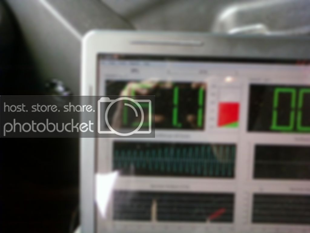

Lets raise the bar a lil more!
Look close gents 40hz!
//content.invisioncic.com/y282845/emoticons/wow.gif.23d729408e9177caa2a0ed6a2ba6588e.gif//content.invisioncic.com/y282845/emoticons/crazy.gif.c13912c32de98515d3142759a824dae7.gif//content.invisioncic.com/y282845/emoticons/eek.gif.771b7a90cf45cabdc554ff1121c21c4a.gif
Very nicely done! //content.invisioncic.com/y282845/emoticons/veryhappy.gif.fec4fed33b4a1279cf10bdd45a039dae.gif
Now let's see readings of 35Hz and 30Hz //content.invisioncic.com/y282845/emoticons/crazy.gif.c13912c32de98515d3142759a824dae7.gif
I'll get that for ya its at 48+ 30hz drops off at 45 and creates overthrow issues:laugh:

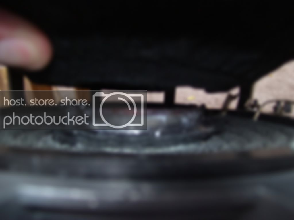

Getting ready for another show tomorrow. Back in NY and happy to see my house!
I'm not pulling any stops. One woofer is week so I'm gonna try and blow it up and swap in the HD3's.
Will have pics and vidz tomorrow.
that is ur triple joint that broke. if ur doing that alot get 1/4-3/16 rope wrap it around the triple joint and soak with thin ca glue such as blackmax (loctite380).
make sure when you recone you put a alot of ca or epoxy on the cone/ former joint on top of the cone...
