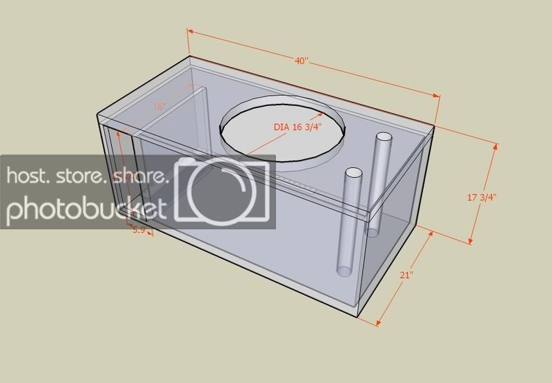

Would you recommend me building a new box tuned to 40hz?
Ill post up the design if you guys wanna see it
double baffled tuned to 40hz
design by DJ
should i got with this??? and does anyone know how different itll sound as in like itll get louder...you wont pick up the lows as good etc....
//content.invisioncic.com/y282845/emoticons/biggrin.gif.d71a5d36fcbab170f2364c9f2e3946cb.gif thanks
No. That is a bad box design, I don't care if Jesus designed it. The port wall extends too far back into the enclosure and your port area changes at the inside of the enclosure. The port will not be as effective as it could be and you could easily get port noise from it.
I think you would be better off going with a different design. I could crank something out for you if you would like.
