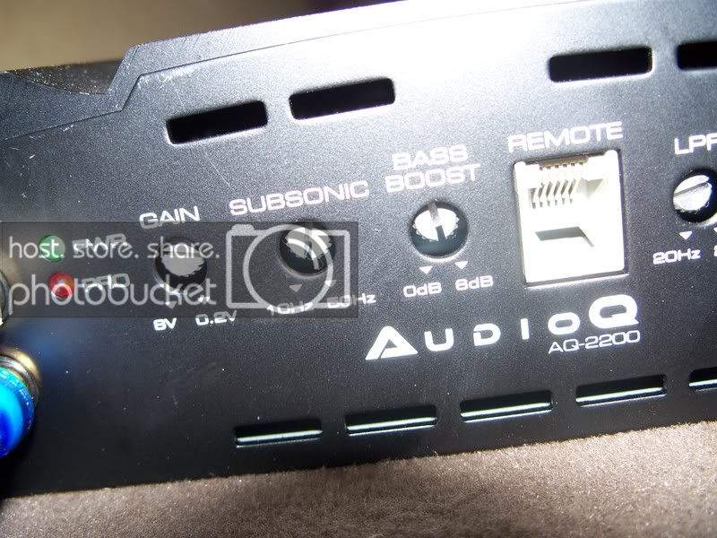

this is how my amp looks right now....
remote gain has the clip led on it. Set the amp gain halfway...crank the remote gain till you see the clip led start blinking.
Also looks like you have the bass boost turned up....turn it back down. My hdc318 didn't move a ton with the aq2200 but it was still new like yours...give it time to break in and see what happens

yeah its hard to tell what you have them set to? i would do like deuce said set the amp gain to 1/2 and adjust the remote gain til u see the red light, thats how i did mine. and when i first got mine i had the lpf too low lol. i would probly set the low pass all the way up and subsonic all the way down first,then adjust them later to like 30hz and 80hz
Why have the subsonic filter OFF when you're trying to avoid playing low notes?
I say leave SSF @ 28-35 and leave the LPF @ 80 and leave the gain @ 1/4 for a few hours, then slowly raise it..
Thats my plan tomorrow, first day gain @ 1/4, second 1/2, third full tilt //content.invisioncic.com/y282845/emoticons/biggrin.gif.d71a5d36fcbab170f2364c9f2e3946cb.gif
