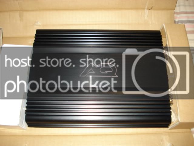

Just an update, Installed and tested these. I am very happy to say the least. First test was in car with a 1ohm load at 13.2 volts and I was able to get 53.2 volts on the output before the dummy clip light came on. That is a little over 2800 watts. In a side by side test my MMats 2200.1 does a little over 2500 at 13.2 volts. So in the real world if you can get close to a 1ohm load you will see the rated power and then some. Now for the fun part, strapped the pair to my 2 DD9515's and they are amazing. There is things moving in my truck that were not meant to move like that. I now have some sick roof flex my rear view mirror is history. Ran the truck at a local comp and the setup did a 147.9 with little to no tuning, not a bad baseline in a full size Tahoe with no sound deadening. I just ordered another pair of these 2200's feed these stiff *** power hungry DD's , that should really bring them alive. //content.invisioncic.com/y282845/emoticons/smile.gif.1ebc41e1811405b213edfc4622c41e27.gif
Now not to be rude. But you did use a clamp on and a volt meter correct? And you are saying 1 ohm after imp rise? If not this test is completely pointless . If it is a WIRED 1 ohm say.... guess... after imp. rise depending on the freq 1.5 ohm. so 53 volts for 1.5 ohm would equal about 35 amps . So 1855 watts RMS at 1.5 ohm. Pretty decent. But that is only if you are talking about a 1 ohm wired test and these are only approx

I have clamped these strapped.
Resting load 0.6 ohms
72.4 volts
47.2 amps
3417 watts @1.53 ohms.
Feed Voltage 13.2 volts.
