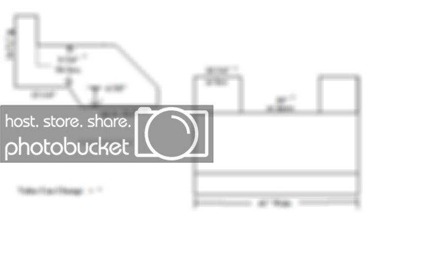

Ive been taking measurments for a box that will wind up ported threw my rear deck. However im not good at calculating weird boxes, Nor port lengths at all.
Im needing someone to help me with a design for 2 15" RE SE's, ill leave tuning ect up to you. The box will take up the majority of the trunk of an 83 Grand prix, And the subs will be seeing roughly 1200+WRMS.
Here's what i had in mind:
Subs would be mounted on the 45 degree angle. If you need any more measurments, Id be glad to get them for you. If you want money for ur time / design, Shoot me an offer.
Btw: i already see a missing measument. port can be no wider then 6" at the top, That measurment can change, but it must stay at 14 7/8" tall to fit the rear deck. And the lower the overall box (Between the ports) is, the more room the subs will have to move air threw the trunk [Via the rear seat]

Ive also thought about the aero's however ive already got the rear deck wrapped in suede and i really dont wanna modify it. If i could go with a design something like this, Each port would sit right below the 4x10 opening, and id just have to trim it a bit.
Acoustically, that design is garbage. You're going to get more turbulence than a Cessna in a hurricane. Do a single 12 or a pair of 10s. If you do single subwoofers properly, they are almost definitely going to be louder than multiples done improperly. The rule of "3" is this: doubling cone, power or adding a port nets you 3db in output. That is assuming that all factors are the same, and it takes far more airspace for a 15" to reap the benefits of its larger cone area, and if not, the speaker won't perform. Do it right with less and you'll end up with more. //content.invisioncic.com/y282845/emoticons/smile.gif.1ebc41e1811405b213edfc4622c41e27.gif
