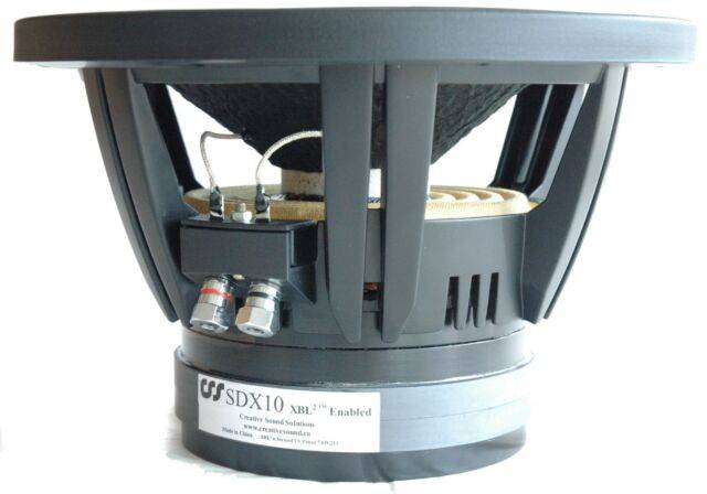

I suppose if we really wanted to fill the slot for a 10" Anarchy we could just go with the SDX10, the price is pretty good and I'm sure they sound great.

How would those work in my doors ? They have been fully treated & simi sealed up ( as much as doors can get sealed lol )

I don't think anyone is getting that driver in their door, lol. It's deep, a full-fledged subwoofer.

Oh ya huh duh lol , wonder how deep mounting depth is ? Didn’t see any measurements.

Has to be a good 6-7 inches deep. And heavy.
