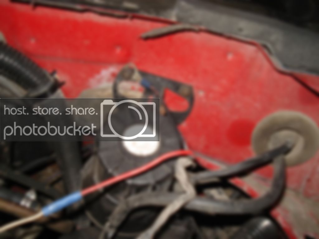

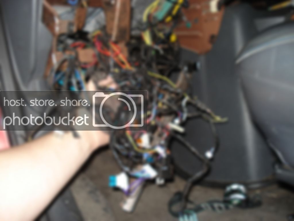

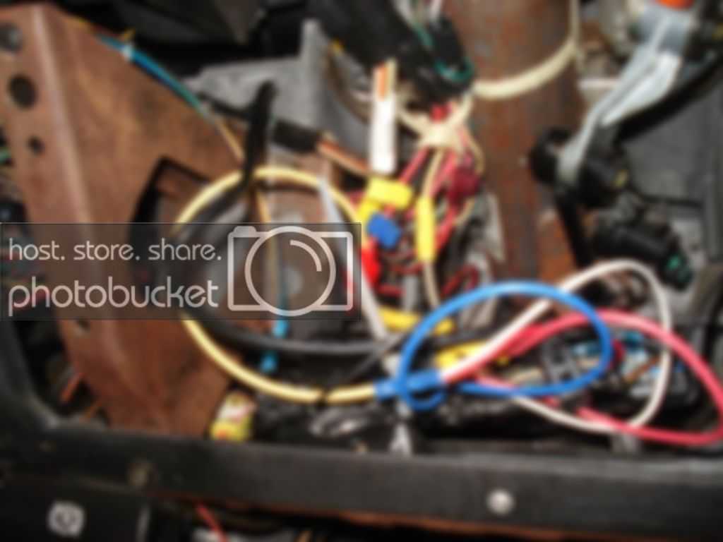

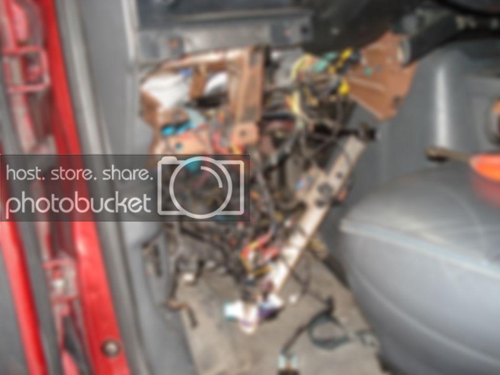

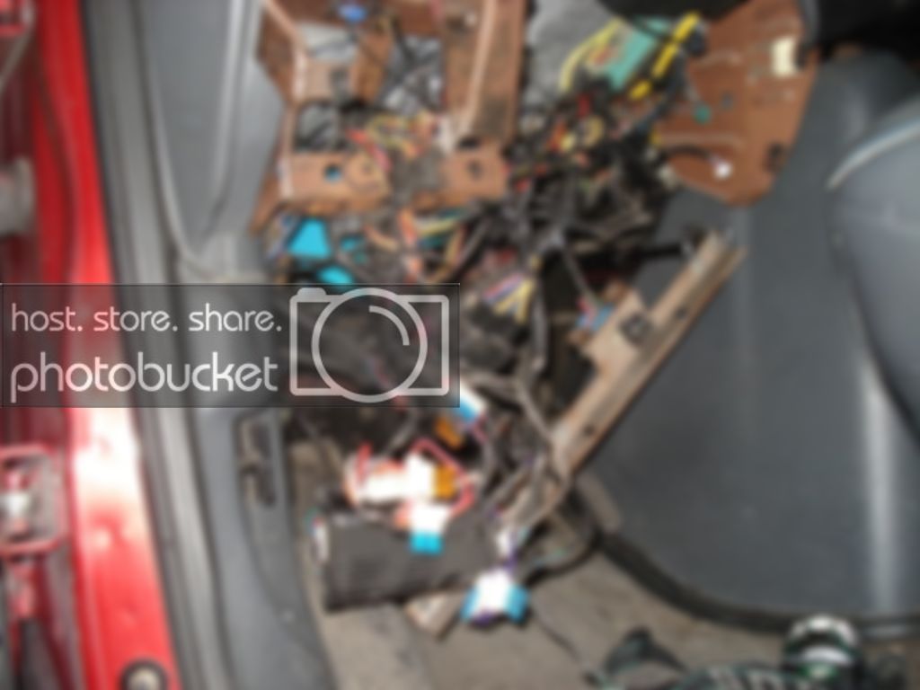

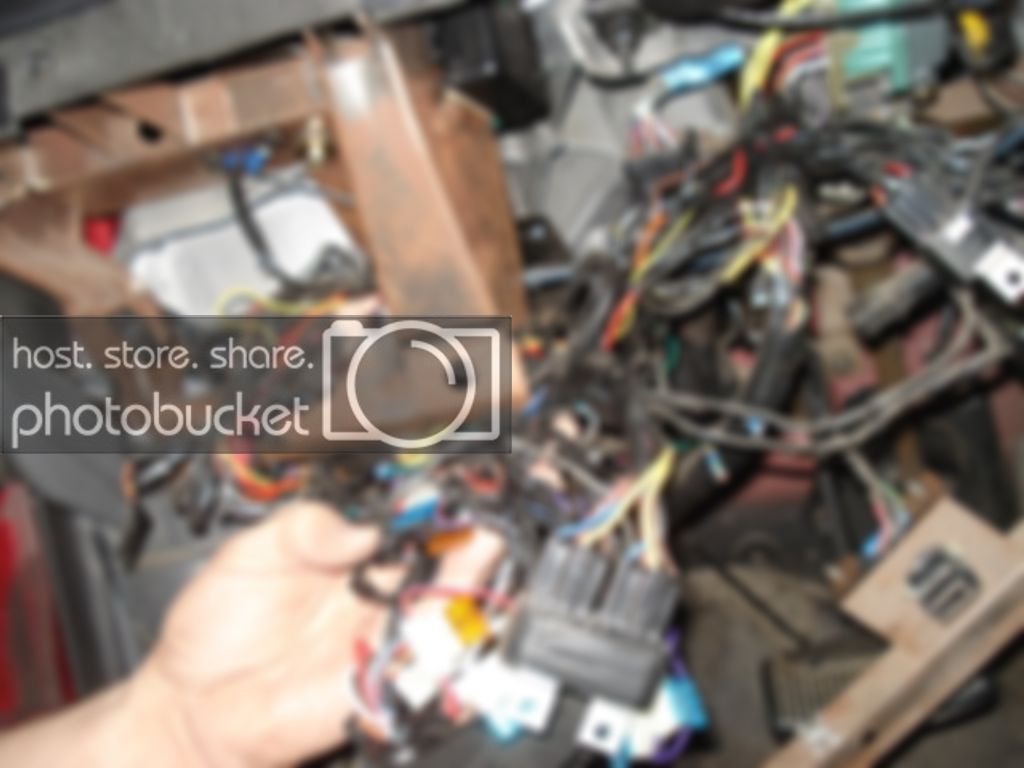

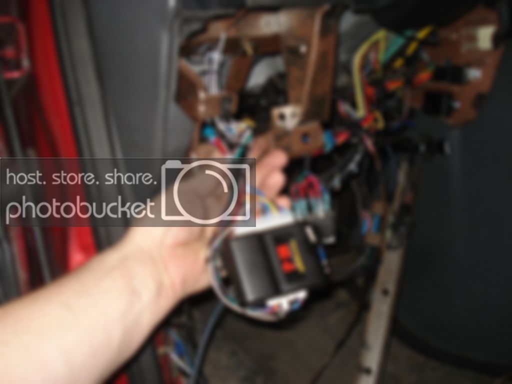

this is what a Cheap Bad Alarm looks like
this is after
