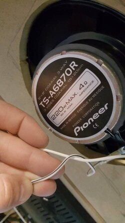

Alex Mar CarAudio.com Newbie 1 0 Mar 23, 2019 #1 i dont have the instructions.. im wondering witch wire (striped or solid white) is positive or negative.. the speaker model is shown in the pic thanks in advance Click to read more...
phantom240 5,000+ posts ALL YOUR INTERNETZ 6,070 15 Southeast Louisiana Mar 25, 2019 #2 Typically, stripe means negative. However, it's a complete crapshoot if some ******* wired it.
Louisiana_CRX 5,000+ posts dem shoes...... 39,673 551 Piney Hills of Louisiana Mar 25, 2019 #3 The one going to biggest connector .205 is positive the one going to smallest connector .110 is negative
