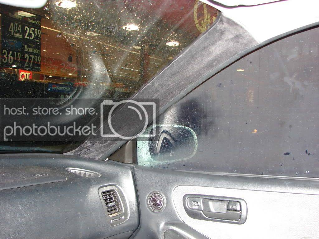

look at the pics...copied from a different thread...i need to know what kind of suede and glue should i use??? i thought suede would be more then what he paid...

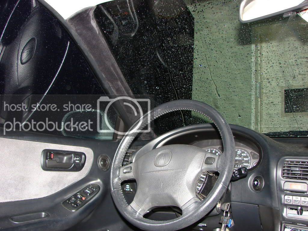

I wrapped the pillars in black suede. Was like 10 bucks for the suede and glue needed.
Camera's flash made my door panels and dash look blue, but everything is black. Looks sooo good. I am going to do the deadline next time I pull the car apart.

okay is there a good place online that sells it or a local store i need to look for? and what kind of gule? how well does it really hold up? is the correct name faux suede?
Lulz. That was 30 minutes ago lol. Got the suede at Joanns. You can get 40% off coupons quite often if you look for them. I used super 77 by 3M. Preparation is KEY. You need to scuff the **** out of the pillars(or whatever you are covering) in order for them to bond together as best as possible. If you got mad contours on the parts you want to cover then it might take a couple of tries to get it right. it was like $20 for everything(and that is enough left over to do my headliner and door panel inserts)...
