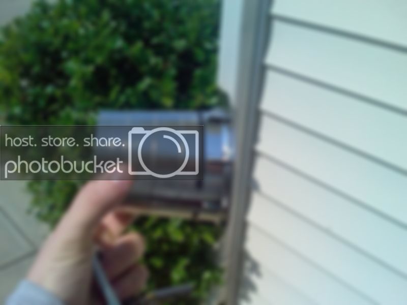

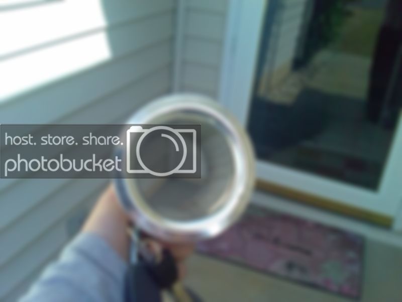

Well I do have two cheap aero posts that came in a band pass box, they are 3 1/4 across and 3 3/4 long. What would this do? oh wow after doing more looking it would not at all. man this is all confusing I can't have the ports be to long as my box is only 20" deep

ok so maybe i should make it 2 inches deeper now those numbers were from the re calc im guessing they would be around the same with aero ports. i wonder is 2 4" ports would work for me as well at around the same length
