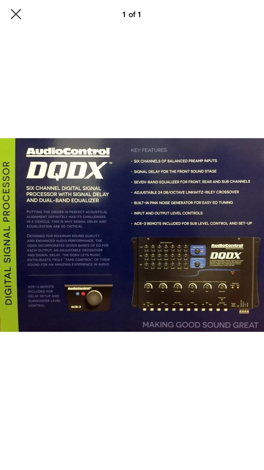

Is this dsp any good? I had it but sent it back because installer said it wasnt needed, if needed ill order it again.
Sent from my iPhone using Tapatalk Pro
Its mine but i honestly dont know what im doing. Last system i built was 20 something years ago in highschool and since then the brands etc have changed allot since then, **** i feel old now lol.
Anyway i told him i thought we needed good crossover or dsp as the ones built in amps arent that great and he said the technology has improved allot and the dsp wasnt really needed anymore.
