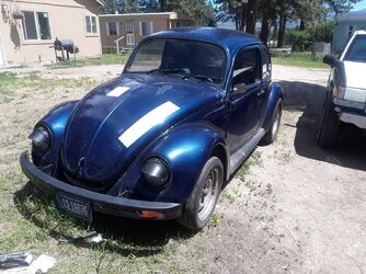

Hi All,
Just popped in for some advice on a sound system for an old bug.  I want to make the most of the acoustics or lack there of but don't know where to start..
I got a cheap *** mechless head unit from the parts house and started putting things together. So far, so Good. The stereo comes on, the one speaker I have hooked to it right now makes noise, life is good.

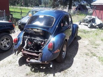

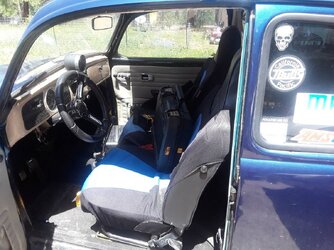

Now in an old bug there is a cavity behind the back seat that you can stuff luggage in, or cover it and fill it with speakers. It had a cover when I bought it so I thought I would rebuild it, stuff more speakers in it and make my ears ring when running down the road I have 2 6x9's, 2 6" round 2 4'? square, all of unknown origin. They make noise but the are probably not wired up right. I ran wires off of the speakers and connected them in ...parallel? Basically I took 3 + wires and 3 - wires and crimped them to my heavy wire running through the car from the head unit.
I wanted to know if a 10" sub in the back back with two 6x9's on either side of the back seat and those itty bitty tweeters up front wouldn't serve my needs better?  I imagine there could be or has been long, long threads arguing the most minuscule details of everything from quality of components to static air pressure but I am not interested in that. I am an old school metal head and I want shear volume without shattering my glass or vibrating like some do.
The 10" is a 500w cheapo, the itty bitty tweeters are 400w, and the two new 6x9's are 200w. The radio is only 4x15w. Will I need an amp to get some head ringing noise out of either speaker set up? Is there a better option(s) for seriously making your head hurt AND be a cheap ***? Not going gold tipped ends and 5kw alternator to keep from melting the car, Just wanna rock really hard in a really small space.
The blue one is mine and the red one shows the luggage area where I currently have sketchily wired speakers and no amp. In the red bug, the back seats back sits up straight between the wheel wells so there is not a ton of space there.
Thanks in advance!
