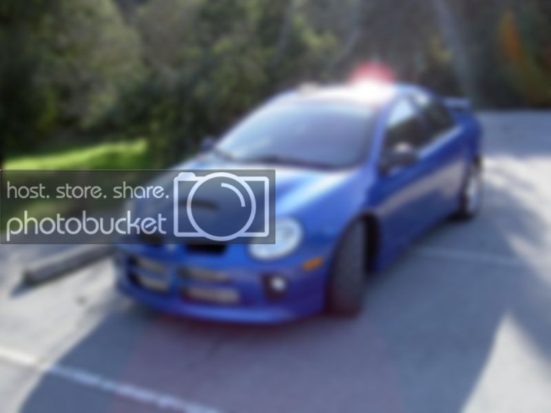

I can help ya //content.invisioncic.com/y282845/emoticons/wink.gif.608e3ea05f1a9f98611af0861652f8fb.gif Here's my little 550 whp Neon //content.invisioncic.com/y282845/emoticons/up2something.gif.dd110ecf3ae4b76050d87598f2f8de7c.gif

Thanks for all the replies fellas. I like your car alot Blue. You said you have your tweets mounted on the a pillars. Is it the side of the a pillar facing the windshield or the side facing straight at you??? I was under the impression that having tweets pointed straight at your face makes them sound a bit harsh.
