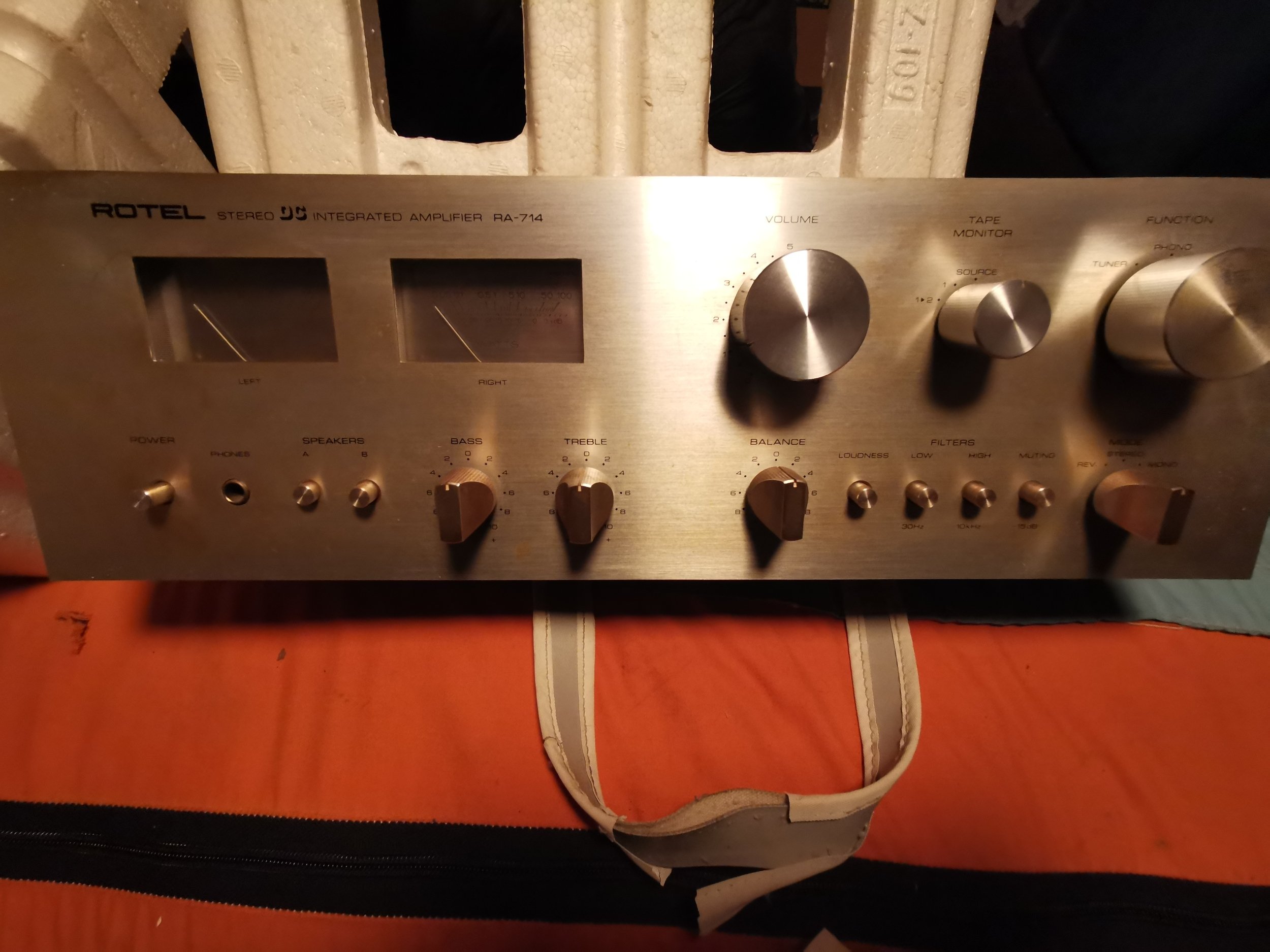

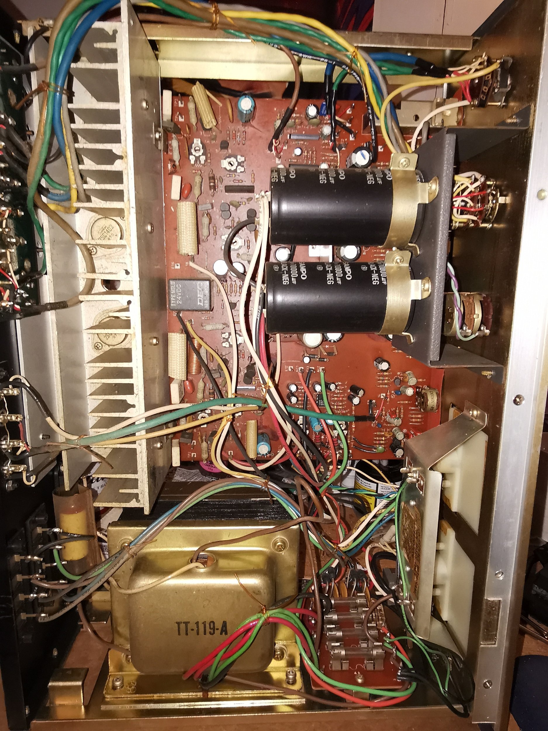

I'm not going to work on my car till spring time unless I have some down time and bring most of my tools at my work place so to kill some time this winter, I've picked up a nice vintage Rotel integrated monster for 300 cad locally last week. For that price, I got the matching tuner, 3 way speakers also by Rotel, a very nice Marantz turntable and an old equalizer made in Japan from a unknown brand.
Got it from the original owner who bought it new in 1979 so of course he had to tell me his whole life story. :sleep:

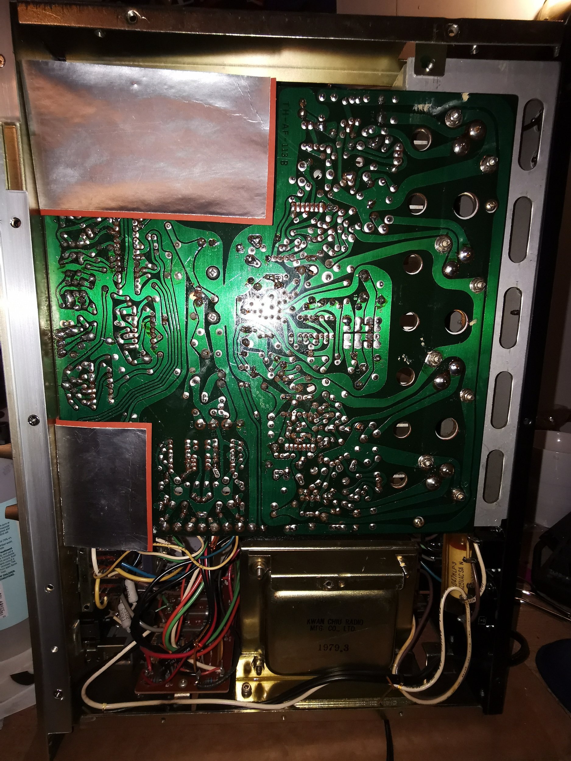

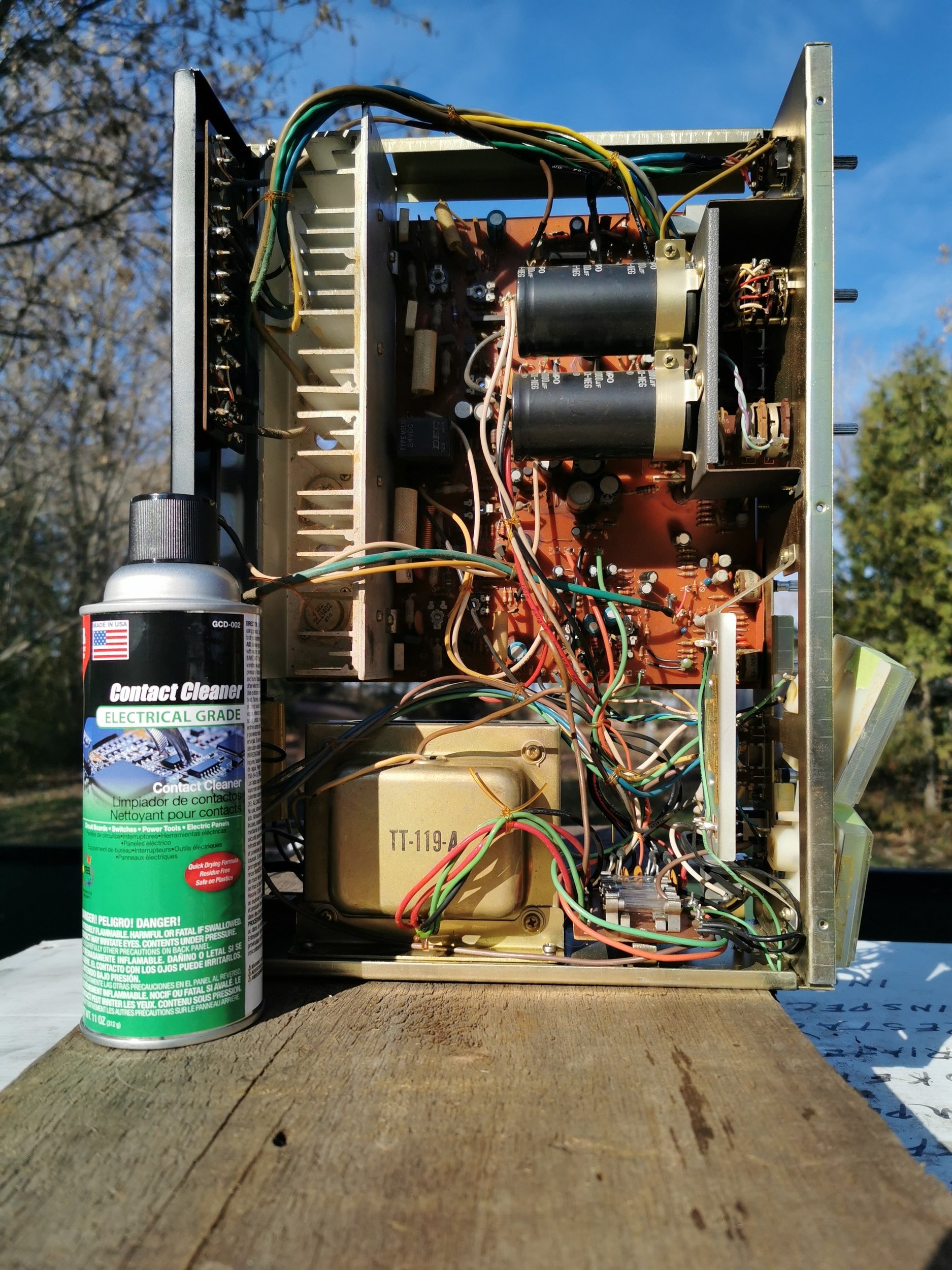

Now the bad. First: the guy was a heavy smoker so opening the boxes triggered the ptsd of my PC repair days. I'm gonna have to spray a whole bottle of contact cleaner into that thing. Needles work but no lights.

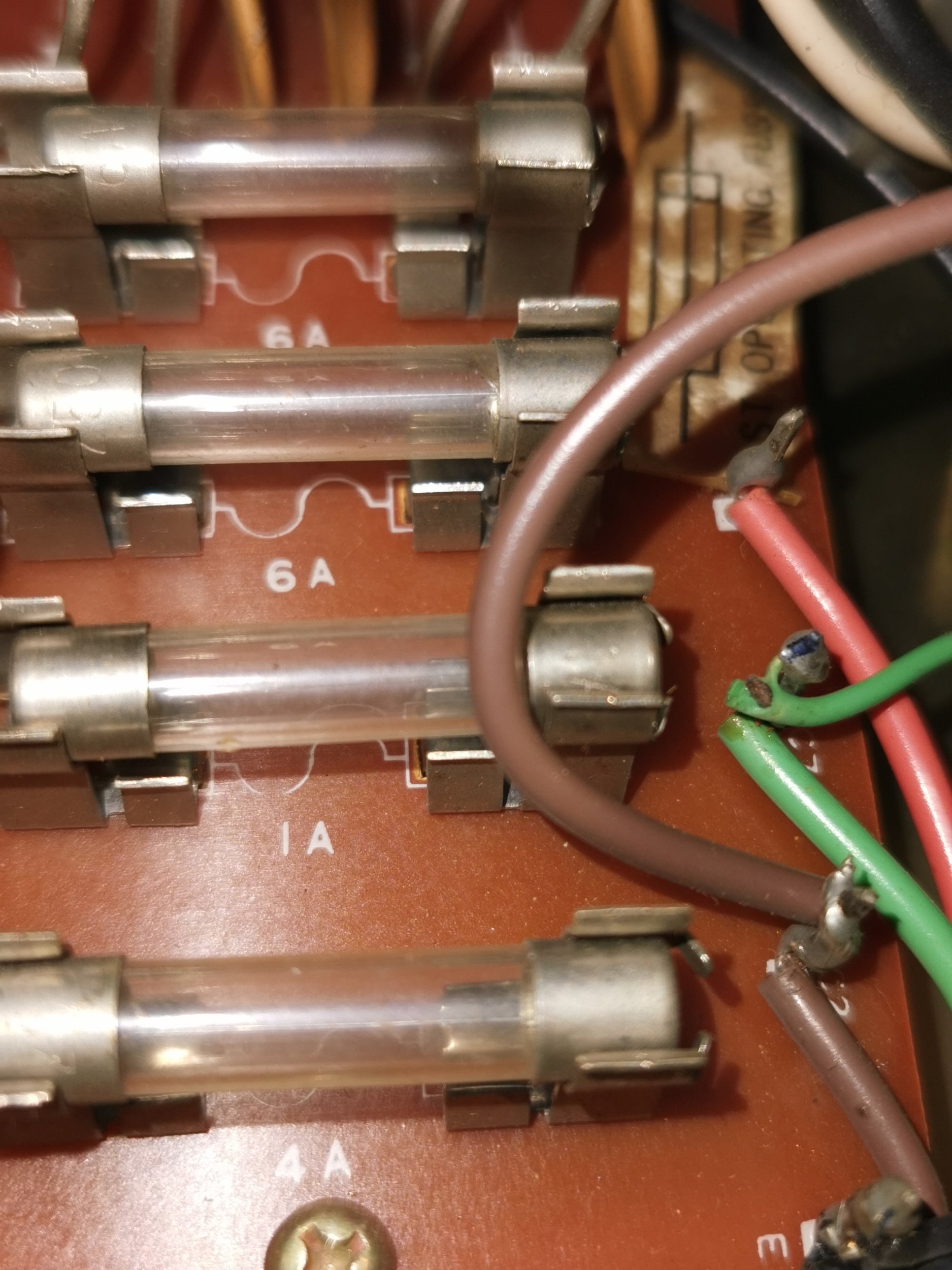

Also I have no sound out of the left side. I'll clean it up, test the fuses and go from there.

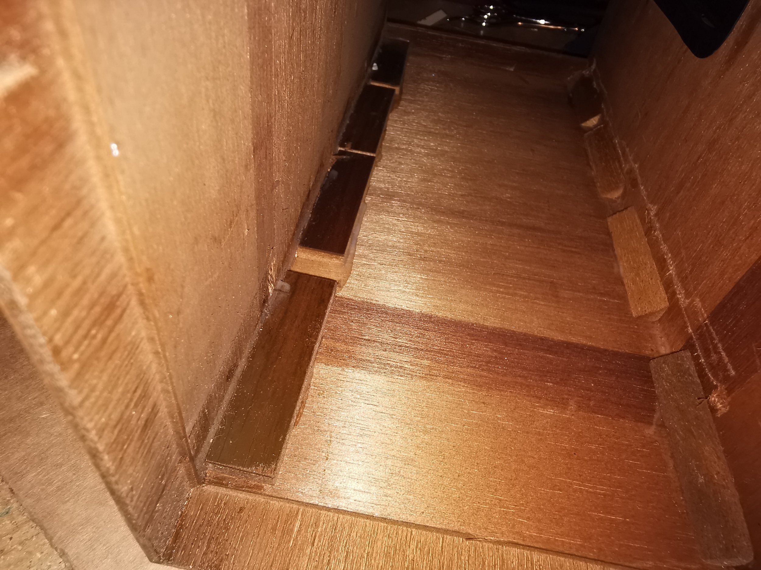

From the outside it looks like plastic but it isn't. Hand assembled laminated wood.

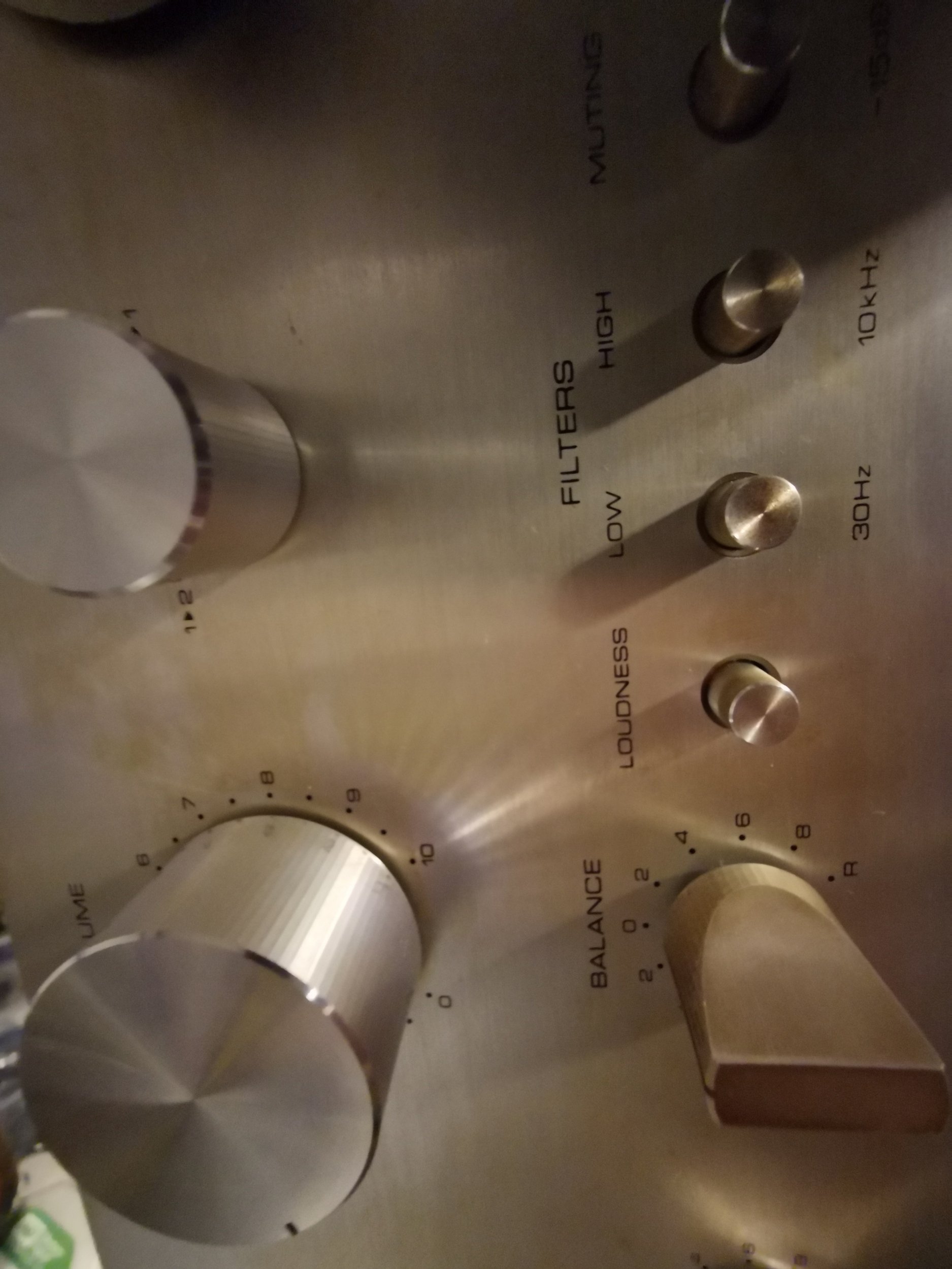

The left channel is back in business. The sound mode selector was the culprit. All switches and potentiometers are now working perfectly except the input selector distorts a bit when used. Since I don't have to take it to my tech; I will probably put in new bulbs and flip it as-is. No restomods. I'll keep on cleaning it as much as I can for now.
