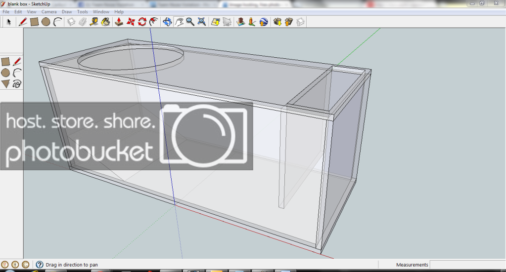

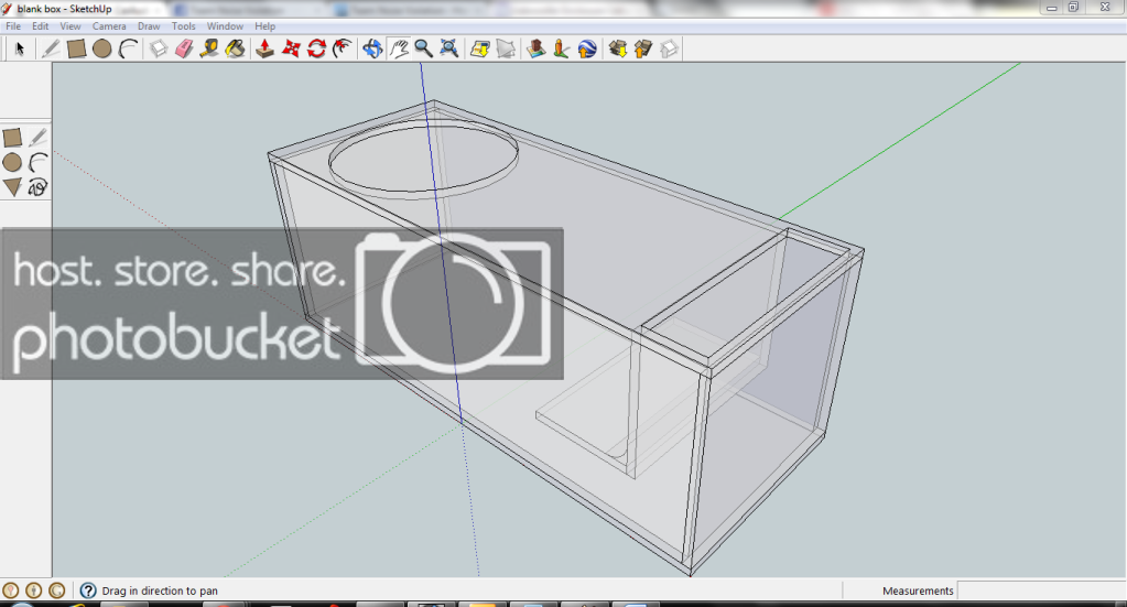

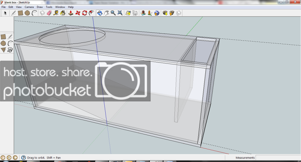

another go at it...
RangerDangerV2
well the box that I just finished (sub forward port up) was a total dud, not nearly enough space.. so this one is 6 cubes after 45s in the corners and port displacement. 87 sq inches of port tuned to 35.
suggestions??
