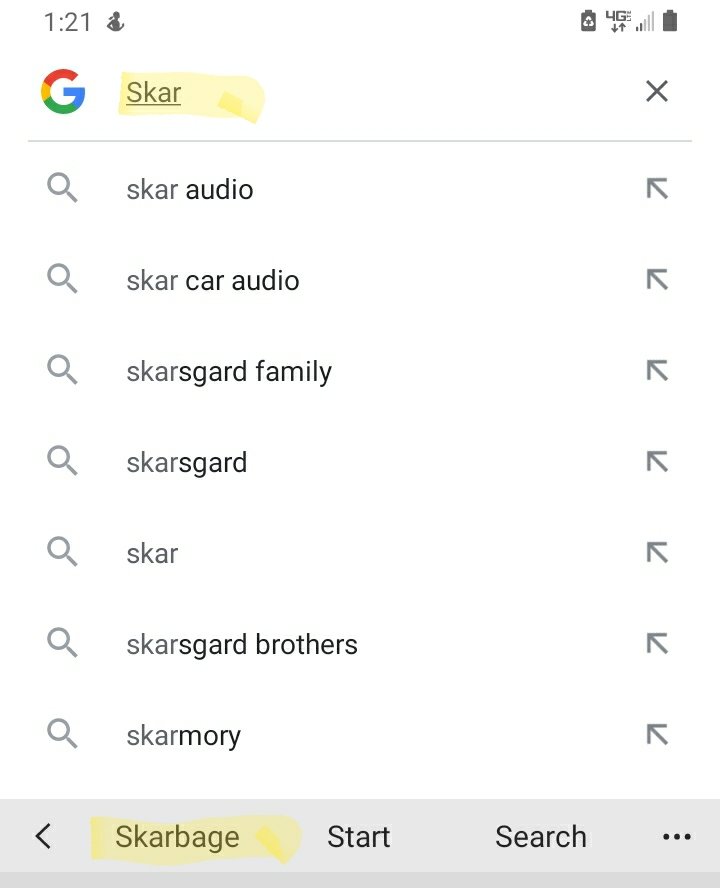

I went to Google a Skar sub and this was an option at the bottom. I was a little shocked. 🤷‍♂️

And who doesn't do that? A lot of companies do that. I know that Skar copies a lot of Sundown stuff and he used to be over there. I just thought that it was funny when that popped up.
