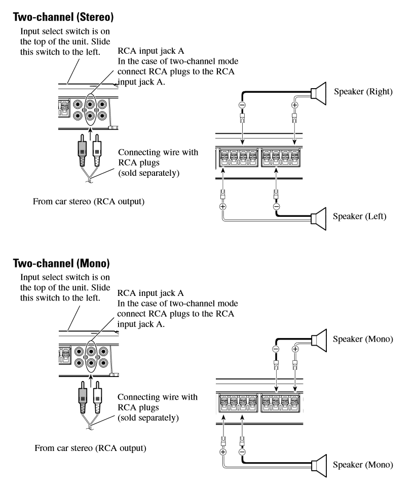

Here is the entry out of your manual that corresponds with hookup of two speakers (or in this case, two voice coils):
For your sub on your amp I would recommend wiring it like the bottom diagram. Treat each "speaker" in the manual page as ONE of your voice coils. It is wired INCORRECTLY in the photo you provided. Pay close attention to the polarity as well.
Just for testing set the LPF/HPF swith to "off" (the center position) for each channel.
Wire it like the bottom diagram, set both gains to approx 50%, LPF/HPF to OFF, switch at 2 channel (or 4 channel if you got the RCA Y splitters). Play Bass I Love You again, shoot a new video, and take a detailed photo of the settings panel on the top of the amp.

don't wire one coil on a duel voiced coil subwoofer..... who told you that. twood like to see if those splitter stop the pop tho.
also for what he is trying todo, there is no correct way of doing it with that amp...... maybe i'm missing something
