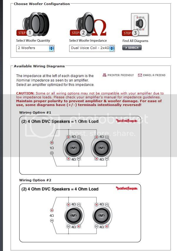

Someone posted this and I have a few questions.
http://www.rockfordfosgate.com/rftech/woofer_wizard.asp
I have 2 Type R 12's DVC at 4 Ohms
So if I use the first wiring method shown I can just run an amp at 1 ohm?
yes you can wire the pair to 1ohm. post a budget and you'll get plenty of suggestions. but some amps that you can consider are a sundown saz1500, hifonics 1606, cadence txa1000d, ed nine.1, alpine pdx 1000.1, used pg xenon 1200.1.
Awesome, and thanks a lot for a good clear answer. Budgets plans don't usually work for me, I'm looking to run about 600watts (maybe 700watts now that this could be less costly) to each sub. I can work better with a goal amount to save rather than a budget, I'll have to save either way lol.
