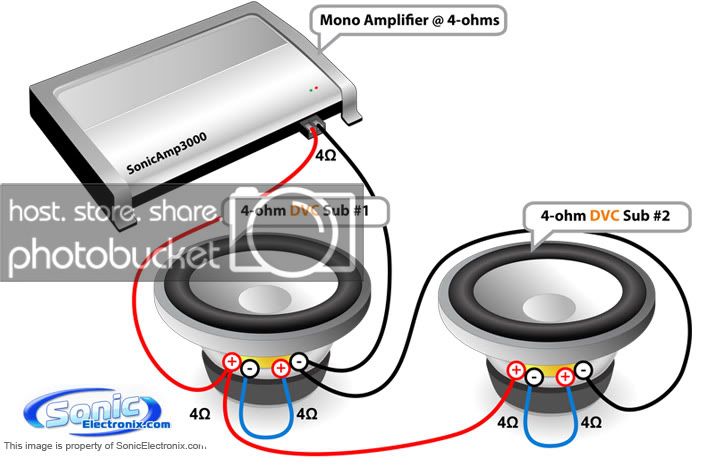

i am new here and i am hoping i could get some help my son bought an amp and some speakers for his car he got 2 of these speakers
alpine swr-1043d
and an amp the brz1200
and we wired them as option 1 for a 2 speaker setup as per the sonic electronix wiring guide
the problem we are having is the amp is over heating he says its so hot you cant touch it we have 12 gauge speaker wire from amp to speakers
and 2 gauge power and ground wires
its mounted in the trunk the amp is screwed to the back of the speaker box
and help would be greatly appreciated on to solving this heat issue
sorry i would post links for the subs and amp for the specs but since i am new i cannot
Thank you

I had the same amp, over heated on me at least 2 times a day, considerably more if I drove for a long time. Did the same thing to the guy I sold it to too.
its wired 4 ohm if you go to sonicelectronix website there wiring guide for subs its option 1 for a 2 sub setup with a mono amp
its not squished at all its on the back of the box
