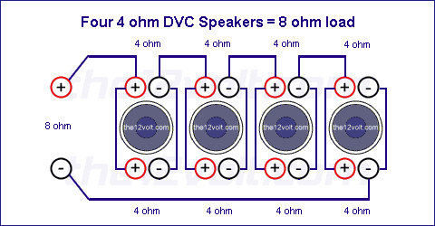

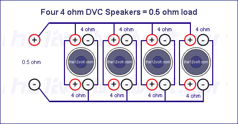

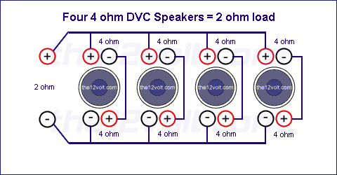

You can wire your subs like the following for example:
