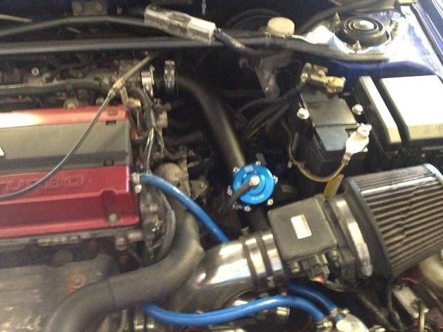

2. getting a cap. now before anyone says anything, i myself am an anti-cap advocate and am constantly telling people to not waste their money. the issue is that my cars battery is super tiny. i have a mini battery instead of the regular battery, it was the only way to get the intercooler piping i wanted to fit. for the most part it works fine, i notice no dimming when bass hits, and my voltage never drops below 13.6 with headlights, foglights, a/c, stereo and sub on. my thinking is the amp is having to really pull for voltage from the small battery, and having the cap would make up for that.
here is a link of the mini-battery for reference
ETS Mitsubishi Evo 8 and Evolution 9 Battery Kit
as well as an actual pic of the battery installed in my evo:
