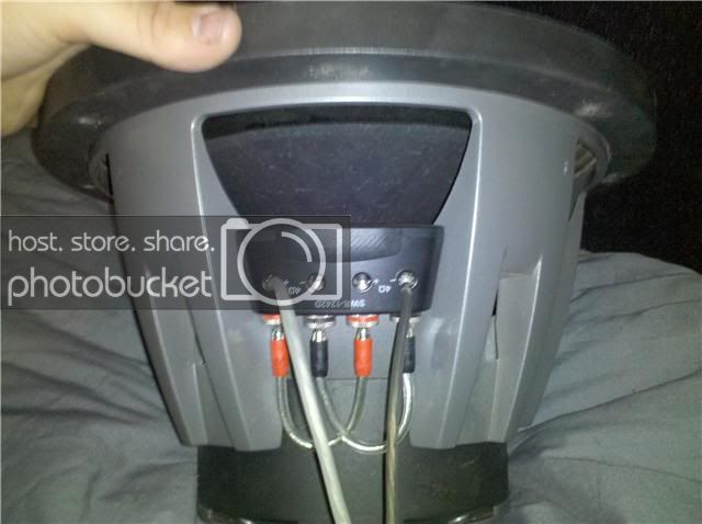

Yes.......IF the sub is 4 ohm dvc. If you have a 2 ohm dvc sub, you'll be wiring it to 1 ohm and that may damage your amplifier.
Take the sub out of the enclosure and post the model number, man. Seriously. Help us help you...
I don't know how to make it any easier for you, bro.
- Take a piece of speaker wire.
- Put one end of the wire in a + terminal on the sub.
- Put the other end of the wire in the other + terminal on the sub.
- Take another piece of wire.
- Put it in one of the + terminals on the sub.
- Put the other end in the + terminal of the amplifier.
- Repeat the same EXACT process with the - terminals.
Do you understand?
Yes very much so i had i wired wrong i had 1 wire in each + and - on the sub so i need it in both +'s and -'s. and then to the amp. after this will i see a difference in performance?
ok i will do that now i guess i was just being lazy and trying to wait till tomorrow to do it but i'll do it now and say modle # and everything give me about 10 mins.
This is how i had it. lol idk why but it just wont hit lows at all. i know it can. i'm thinking it needs more power.. out of the 1500 watts how much is it getting.
It was wired like this already idk why the hell it wont hit my lows then darn it lol! like i cant listen to "***** money weed" because the lows u can barely feel but if i go touch the sub its moving when it hits them.
most prefabs are tuned high thats probably why it is distorting on the lows....does your amp have a sub sonic filter?
I have no idea its a Mtx thunder 6500d i can't find a good specs on the amp would be nice to know //content.invisioncic.com/y282845/emoticons/smile.gif.1ebc41e1811405b213edfc4622c41e27.gif
So to hit lows better i need?box
