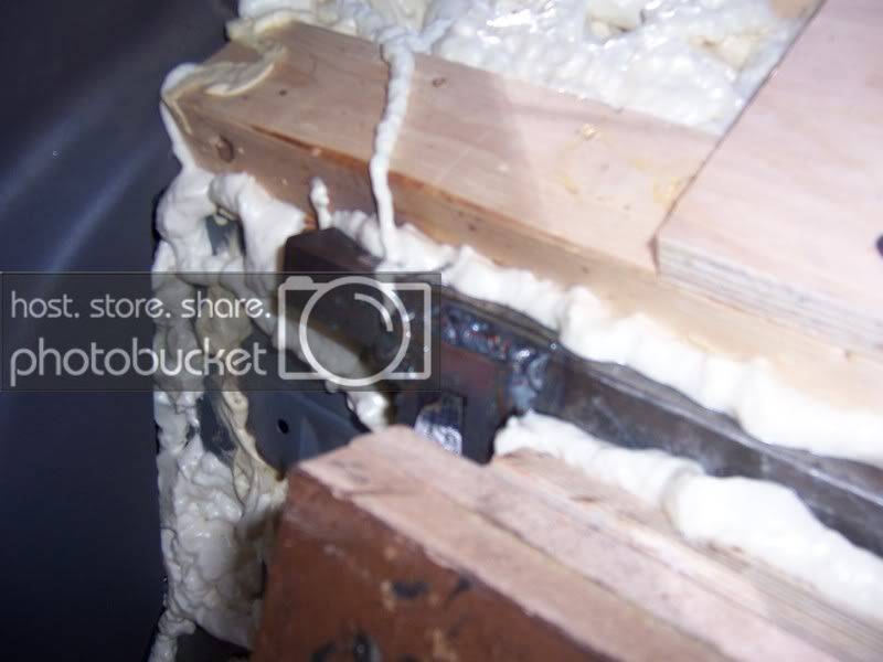

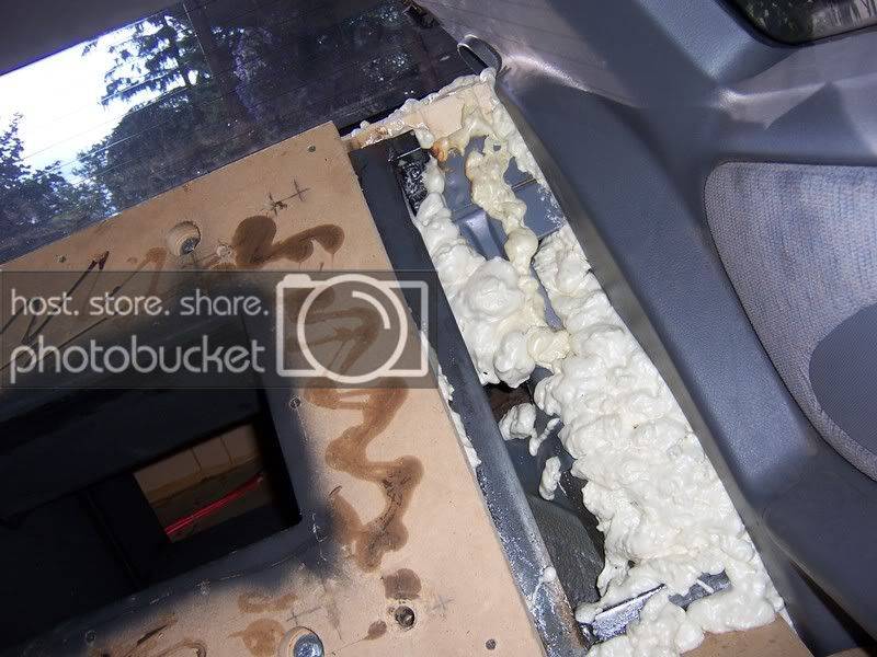

Are you talking about metal for an enclosure? I dont think that would work out too well with it resonating a lot. Ive used metal for bracing and structural work.
Heres a couple pics but Im not too sure what your looking for
I put the bracing in to strengthen the back of the car and the deck up again after cutting out a little metal and taking out some bracing for the cars chassis. The frame I welded in has a square piece of 3/4" stainless on the top deck, and one running across each wheel well, with angle iron going up the sides of the box so I can bolt the enclosure in.
Hope this helps //content.invisioncic.com/y282845/emoticons/confused.gif.e820e0216602db4765798ac39d28caa9.gif
