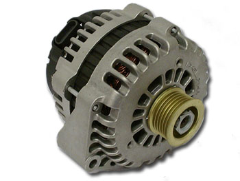

Look out for rusty AD244's at the junkyard, you want no shaft play, and no grinding or rough spots when you spin the bearing
Do some googling to see what an AD244 looks like.
If you're in ATL like it says you will have no problem finding a junkyard big enough to have some AD244's but they are usually one of the first things to get stripped out
You want it to look like this, notice the size and black band
