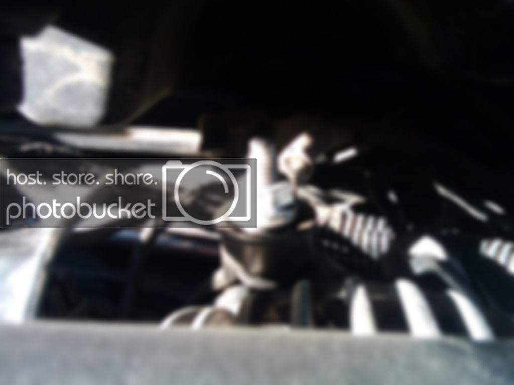

Doing 1 of the big 3 right now. Im pretty sure I found the pos. on my alt lol. I followed the wire and it goes into my fuse box. Is this normal? Just making sure it is the alt. pos before I go connecting wires. Ill just connect alt to battery positive. Thanks

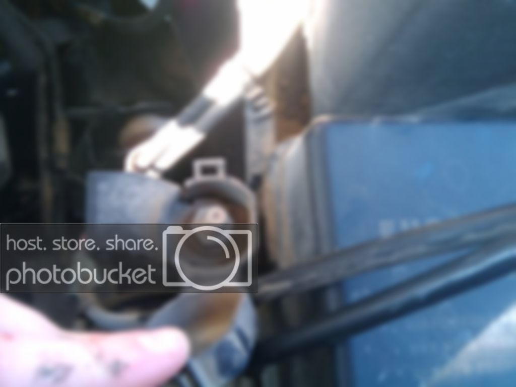

The wire coming off it actually goes to another little box with a platic clip on it next to the fuse box. Here are some pics:
On the alt:
By the fuse box:
my alt positive goes into the fuse box. i just took 0 gauge straight to my battery positive and fused it in between. you dont have to go through the fuse block on the alt positive to battery positive connection.
Well if I am on the right wire, which of the spots to I connect to? Straight from alt? or From the other spot next the the fuse box?
well if it not the pos then when u connect it youll have a spark shower i grounded my fuse block yesterday when i was removeing the fuse and got one. an dont forget the fuse on the alt to batt wire
