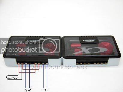

Hey all, looking at the Alpine SPX-13REF and I see the Woofer / Tweeter have their own inputs. Is it possible to parallel wire the woofer connection to the tweeter connection on the crossover so that it only uses one channel on the amp and drops it down to a 2Ohm load? It seems logical but will the crossover handle it and is that proper wiring for seperate input crossovers? I've only used Type-R components before and they have only 1 input/2 outputs. Or do they each need their own channel? Any info would be great, thanks.
Here's a pic of what I'm thinking in case I sounded like I was rambling ...lol

There are jumpers inside the case to do what you are showing.
It lets you use one input to drive both speakers.
There are only 2 sets of inputs to give you the option to bi-amp the speakers.
