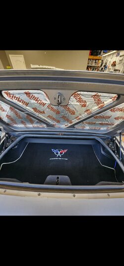

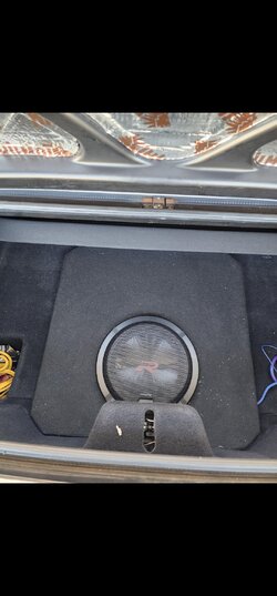

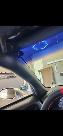

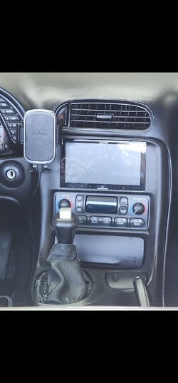

I have a 2001 corvette convertible with the Alpine ilx-w770 and hidden Alpine R2-W12D2 in the back. I can not get my microphone to stop picking up the talker from the speakers. It is causing an echo that only they can hear.
There is no microphone gain setting that i have found yet. I have reached out to Alpine and they have no idea.My microphone is on the top of my a pillar on the driver side. Anyone have this issue?

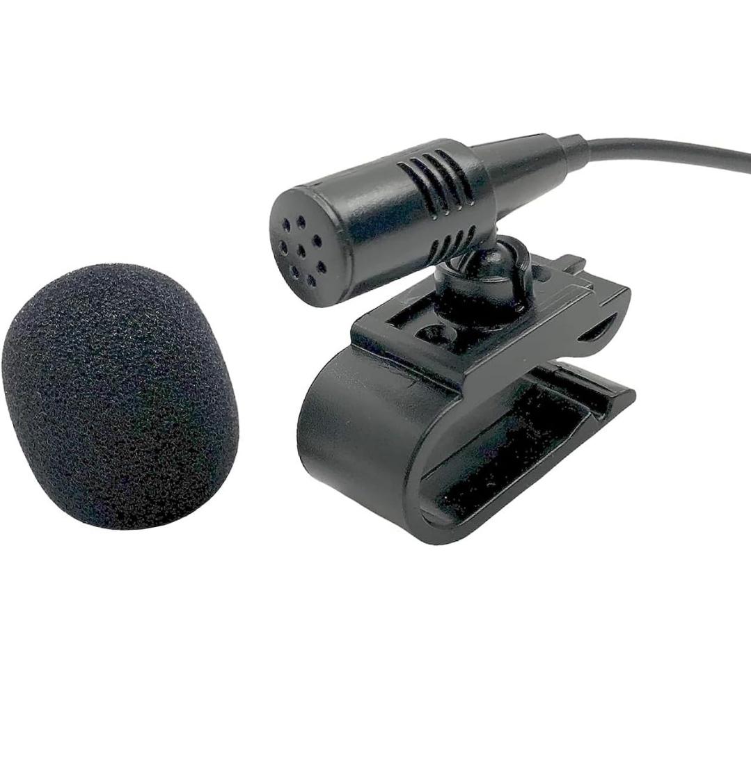

2. **Microphone Type**: Check if your microphone is a directional type. Directional microphones pick up sound primarily from one direction and can help reduce background noise and feedback.

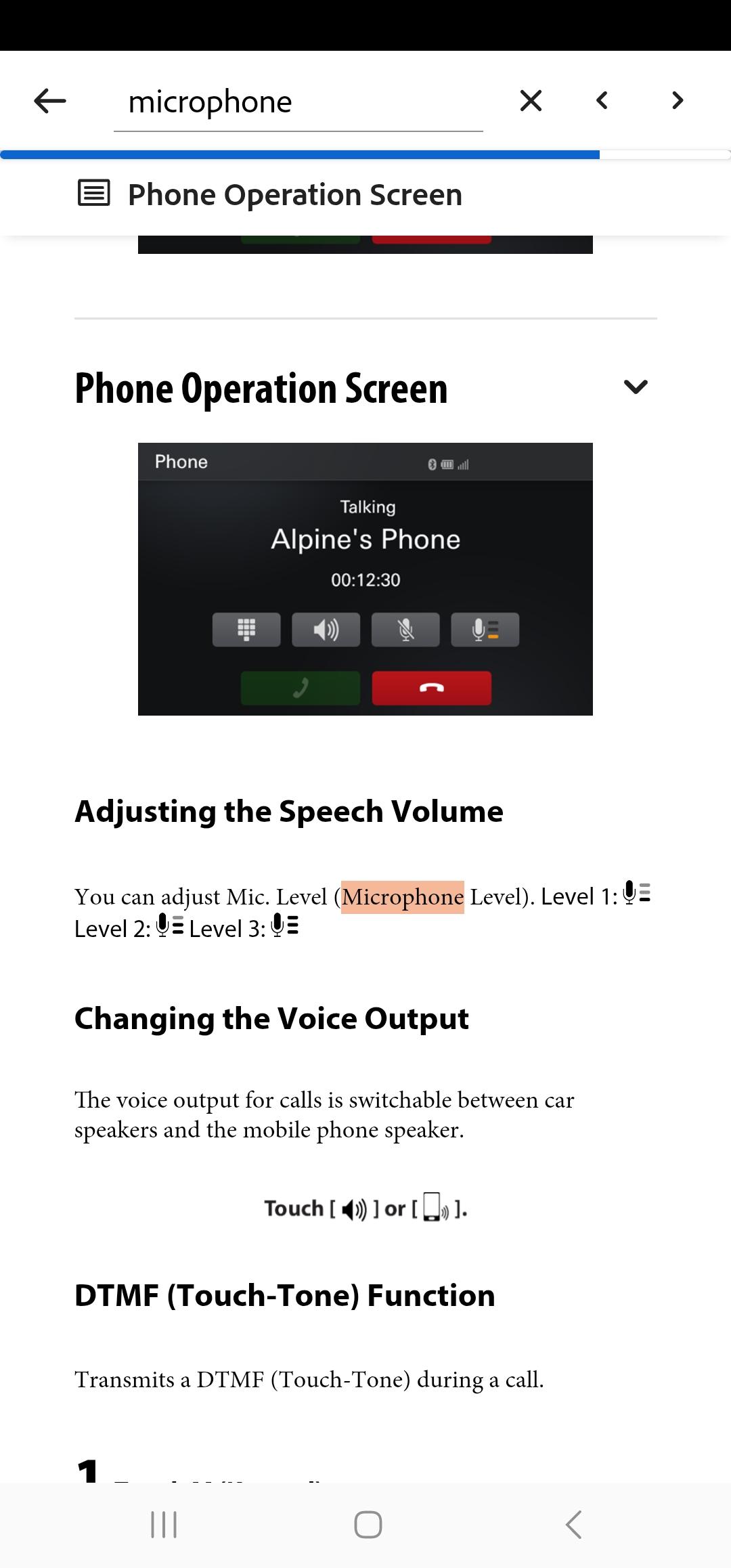

3. **Sound Settings**: While you mentioned that there’s no microphone gain setting, check again for any audio settings related to echo cancellation, noise reduction, or similar features within the head unit's settings.

Yes i thought I did by moving the microphone from the center rearview mirror to the driver side a pillar and the volume low. But it was hard to hear them talking and the echo was still very faint on their end. The microphone i am using using is the stock one by alpine.

Another trick might be adjusting the aim of the mic so the output of the speakers is "behind" it, like they do with stage monitors at live performances, to reduce feedback

I think that T1000's directional microphone is a good idea. I think the radio itself is the issue. When reading about these issues for the Pioneer Appradio, the manual stated the unit has a logic circuit that picks up the speaker's "voice" and eliminates/attenuates it. You may want to test another phone or carrier just for shits and giggles. I know the old Cricket Wireless had lots of echo issues, so any carrier may have them as well.
