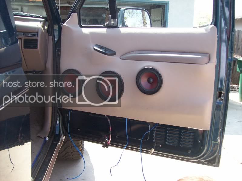

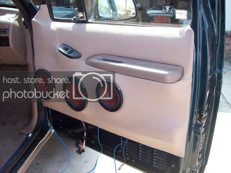

Alpha 18's on 3250's

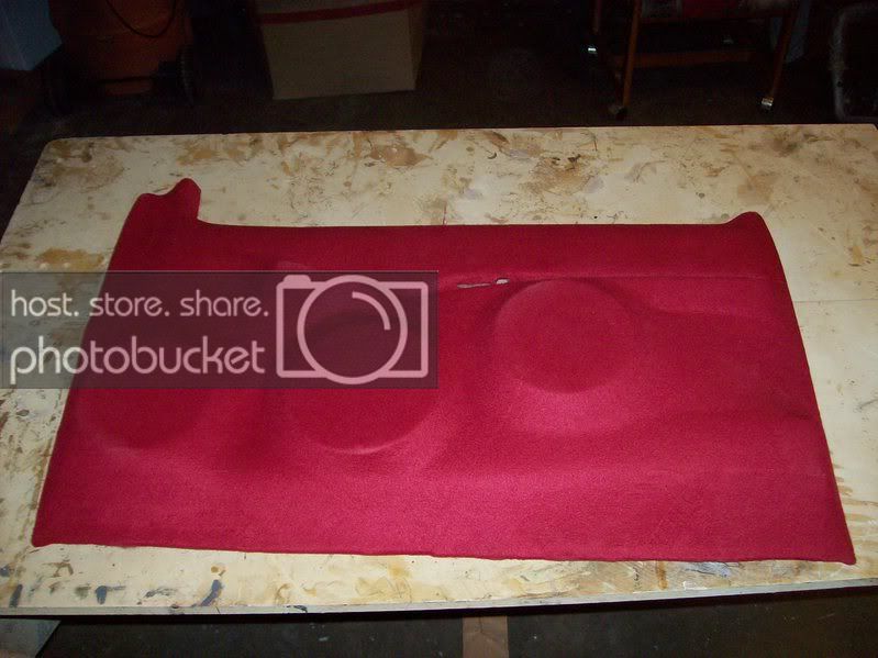

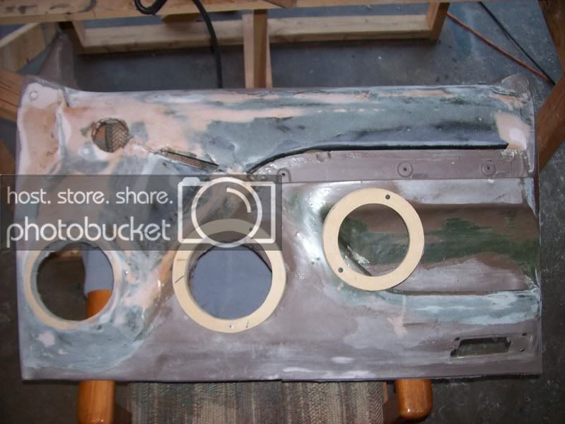

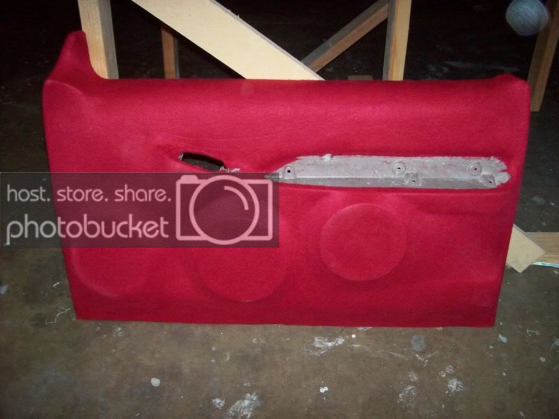

Fiberglassing fail. You're supposed to stretch fabric over your skeleton, resin that for a hard shape, and then glass on top of that.
yea figured that out later, next ones will be better, what kind of material do you use ? i know it has to stretch, would have been alot easier actually
Three sets of components two 6.5 one 5.25 three titanium tweeters (MBquart)
Fleece is ok, I prefer ponte or another polyester type material. T-shirts work, but aren't as stretchy as ponte.
I used fleece on those last pics today, im gona glass em and work em then have em wrapped in leather //content.invisioncic.com/y282845/emoticons/smile.gif.1ebc41e1811405b213edfc4622c41e27.gif
