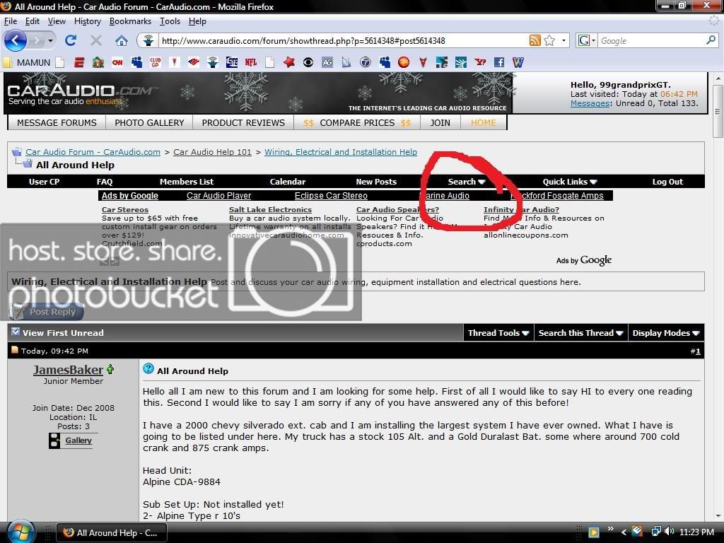

Thank folks for the info. For the 10" R the box specs should be 0.5-0.8 sealed. My box is right around .6cu. with the sub in the box. I can't fit much more because I am mounting the M-600 in between the boxes on the shaft tunnel. I am using one face plate to go clear across the boxes under the seat. I am building my box tomorrow so If I can gain a little more valum I will. I can not go ported because I dont have the room.
Whats the word on Polly fill? Does it really trick the sub in to thinking it's in a larger box? I have never used it. Also I guess it is safe to be packed around the sub wires and all?
Also I am not sure what the Big 3 is. Any help would be cool, I will look here in the wiring for that.
Also can some one point me to a Search box for these forums?
